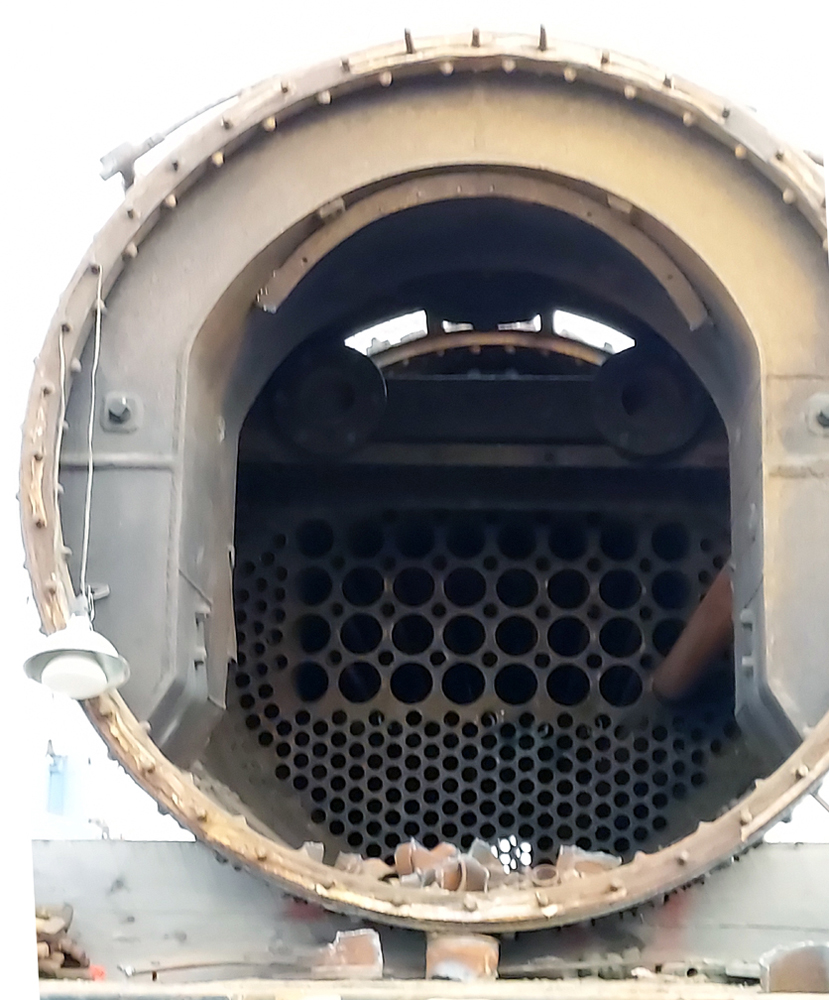

File comment: Finally, the old tubes and flues are being pulled. Once this work is completed, the boiler interior and exterior will be needle scaled for U/T testing.

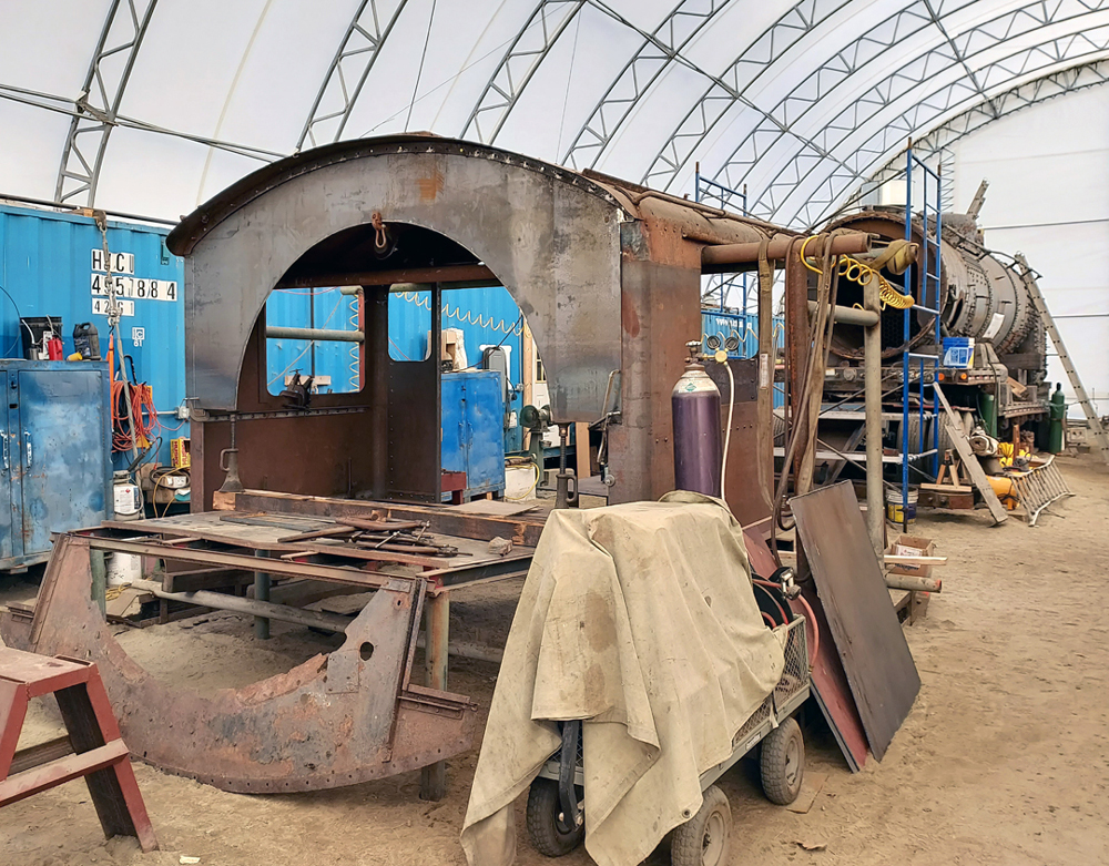

File comment: New steel now supports the original cab roof. New wood frame members and lining has been cut and prepared for installation, once the remaining riveting and welding are completed.

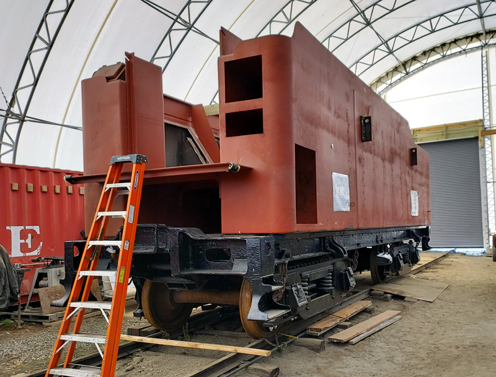

File comment: Critical note here is the original frame was completely restored with some remedial repairs. The brake lines are all new and with a few rebuilt components. The trucks have been been restored to almost new condition. This has been a true labor of love for over a score of dedicated volunteers over the past four years.

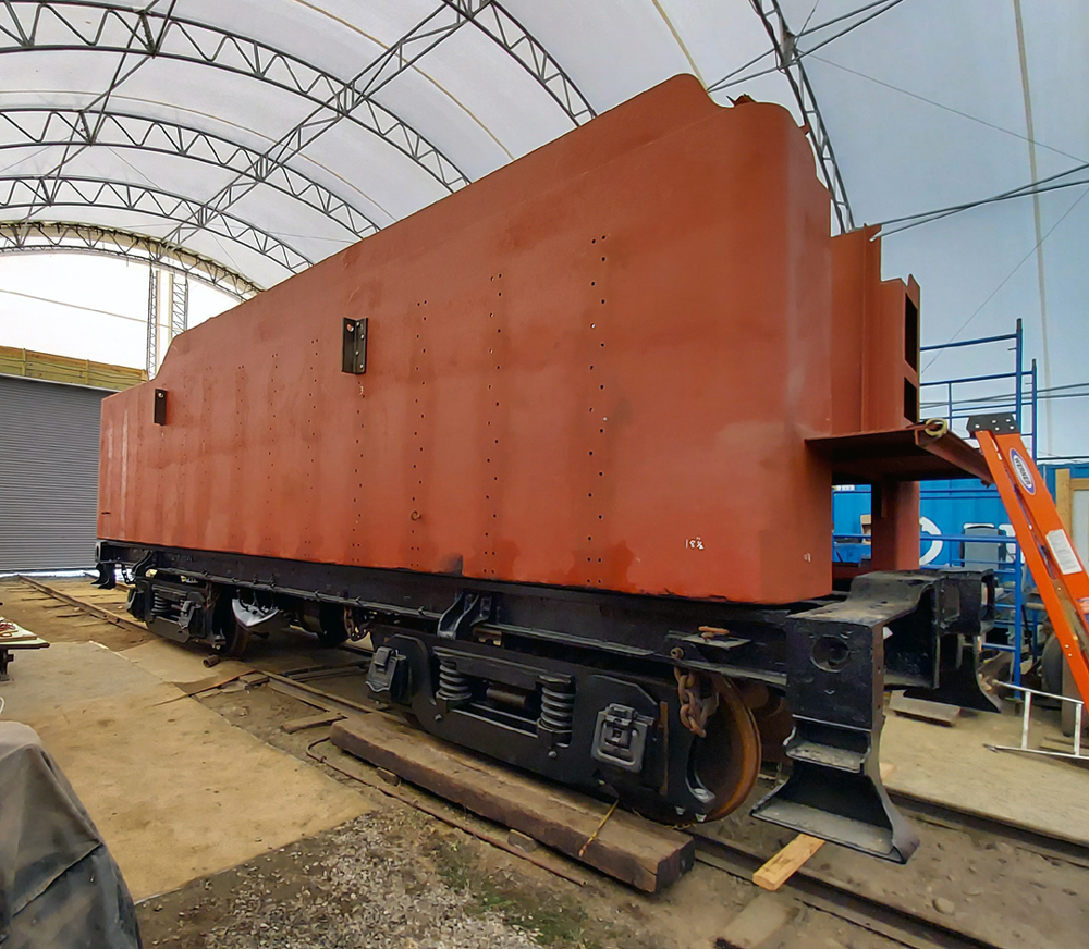

File comment: The new tender tank is an almost identical copy of the rusted out original.

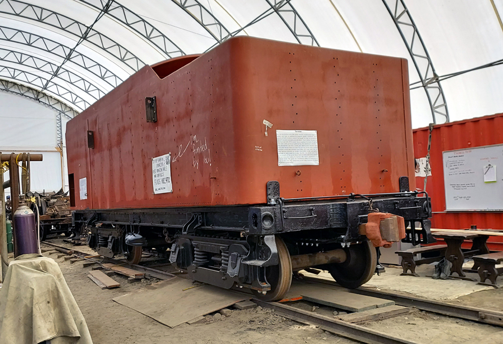

File comment: New tank set upon the restored tender frame.

How do you get tubes in and out past that water heater?
 Post subject: Re: Maine Central 470 and New England Steam Corp!
PostPosted: Sun Nov 20, 2022 3:17 pm
Posts: 110
You don't….. have to be pulled back and passed thru a clear hole. The feedwater heater is an obstruction for a few chores. It has been badly damaged from freezing when water entered during the many years on display. New England Steam will be removing the feedwater heater from the smokebox in the near future. There are currently plans not to use it or the turbo pump.
