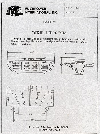

Hi All
For those that posted and were not sure what and HT-1 Firing Table looks like, I found a diagram on the internet showing the table. Pat.
File comment: From the internet .
