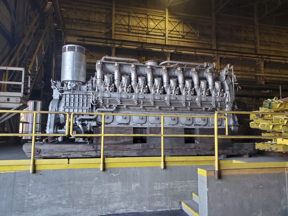

The discussion about the Flying Yankee (and its Winton Engine reminded me of an interesting observation I made recently.

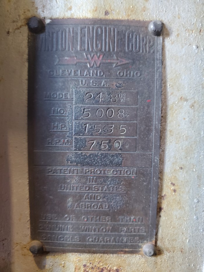

Not long ago I had the fortune of encountering a couple of similar engines. A Cleveland, and a Winton, both were V16 248 engines with one Roots blower. The manufacturer's tag on the Winton specified that the engine was to operate at 750 RPM and produced 1535 HP. I recall that the V16 567 EMD operates around 800- 835 rpm but, the HP rating was only ever 1800 at max for roots blown versions. What were the differences between the two?
I also seem to remember the Winton was the predecessor to the popular EMD engine. Does anyone have any information about the evolution of the Winton engine into the Clevelands and the EMDs of the later years?
Thanks.

Thanks, Preston.
The short version is the 201A was the original production engine for rail, marine and stationary uses. Problems arose and were solved. It soon became clear that the rail and marine/industrial applications had different requirements so the 567 for rail, from EMC, and the 248 for marine/industrial, from Winton and later Cleveland were developed. 567 is the displacement of each cylinder while 248 is the engine's place in the Winton line, and was slightly larger than the 567.
As an exception, in WWII, Cleveland production was fully booked and USN ordered about 2000 12-567's for LST's (Landing Ship Tank) which were essential for amphibious landings. Each LST had two 12-567's.
Early in WWII, Cleveland replaced the 248 with the larger 278A which powered Destroyer Escorts and Fleet Submarines, among combatants, and a number of Fleet Auxiliaries. To close the circle, in 1944-45, USN used 12-278A's to replace the 16-201A's in the surviving early 1930's subs.

The engines pictured are the "spares/parts engines" that the USS Cod acquired from the Submarine Stingray that are stored. Cod has since stopped running their engines in the sub though unfortunately. Fireboat Fire Fighter has a pair of 248's that are run a few times a year, as they still get underway, but they are tired.
A minor correction, the 278 came in-between the 248 and 278A, although not many were built. There is still a few of the 278A engines that repowered those 201 fleet subs running in tugs owned by Great Lakes Towing, who is the last major user of 278 family engines left.
