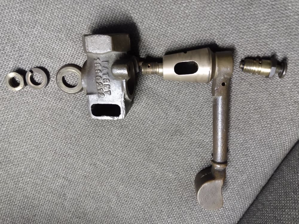

Hello,
I recently purchased a Sherburne Caboose Whistle, Pat. 1890212. When hooked up to a compressor, it leaks a great deal around the button shaft. I disassembled most of the whistle, and saw that the air valve is a cone shaped object mounted on the button shaft.
Here is my problem. Is the hex nut surrounding the button shaft, an actual separate hex nut, or is it part of the casting? It would seem to me that it should be an actual hex nut, in order to access the air valve. However, I didn't want to force it for fear of breaking the casting. Any info or suggestions? Thanks!

I pic would be nice so we know of which you speak. But I’ll go out on a limb. Is it a small whistle that goes on a monkey tail? If so the hex castings should unscrew. There may be one at each end of the button shaft. You may need to clean and polish the valve mating surfaces if they’re metal to metal. There may be flat gaskets or o-rings under the hex portions and an o-ring around the button shaft. If o-rings, lightly lube them with a bit of plumbers grease when you replace them. Vaseline doesn’t last as long and might deteriorate the o-rings.

Exploded View

Thanks for the tips, gentlemen. The pic with the disassembled whistle answered my question. I now know that the hex nut on the button side is in fact a separate piece. I'll have to work on it.

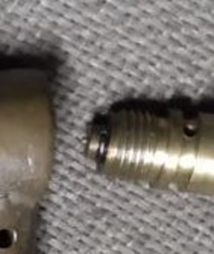

The hex is not a nut, but is connected to a sleeve that contains the spring for the push button. The fault that we have found on many of these is the tiny oring at the inner part of the button shaft. This is what seals the air for the whistle. If that oring is split or missing, the air leaks out around the button shaft
