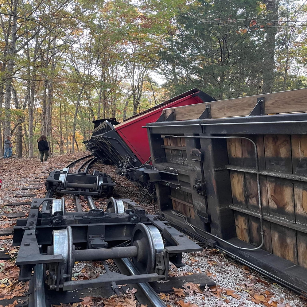

The tourist train at Silver Dollar City, Mo. had quite a derailment!!!! Looks like it did what we call "stringlined". I thought of inserting the word "spectacular" into the headline.... for it was!

I would be interested in learning what the proximate cause of the derailment was. Appears to be a stringline, perhaps caused by a derailed wheel towards the rear of the train. There is a skewed tie in one of the videos, could that be where a derailed wheel dropped between the ties and created enough resistance to flip the rest of the cars over?

Video of derailed train. Truck that is off the end of the ties is probable cause of over turning the cars. I doubt that little engine has enough tractive effort to affect a true stringline. Coaches seem awfully broad for the gauge of track in my opinion.

Wouldn’t take all that much to string-line. High center of gravity and momentum. My theory - lead truck of the next to last car dropped off and caught the end of the tie on the low side. That jolt and resulting string line force could start things tipping while momentum carried the cars almost another car length. Note that the curve is sharp enough that there’s a guard rail. Here-say on the street is wide gauge. All speculation at this point.

What little bit you can see of ties... no marks on the ties, so it doesn't look like something was off on the ground dragging along...and, as good as everything looks, hard to imagine "wide gauge" being a possibility. The tread on those wheels is wwwiiiidddeee!
At the beginning of the video, you can see where the end of a tie on the low side was caught and plowed forward resulting in the skewed tie noted by Rick. Those cars may not be heavy enough to leave marks on the ties that would be obvious in the video. A witness stated the car was bouncing just before it went over. I’ve seen a covered hopper being switched and dropping off the rail making little damage to the ties. You wouldn’t have known unless you were looking for it.

Slightly confused on why you would have guard rail on the partial inside rail of a curve.
The wheel treads are surprisingly shiny all the way through the flange edges as well as the full-width treads.
There was a derailment on RJC a few months back that made YouTube video where a side dump rock hopper at the front of the train managed to sequentially roll over, slowly, about 20 cars behind it, literally, a slow-motion train wreck. The twist forces transmitted through couplers when the gauge is that narrow makes this real speculation.
Guard rails for guidance are normally on the inside of a curve... but this one obviously isn't for guidance, being almost 1/4 of the gauge from the running rail. This guard rail is to contain a derailed wheel, so the truck stays up on the track, rather than letting the car topple down the embankment. Whatever, it was on the wrong side to be of any use in this situation.

To my eye it looks like there are at least 3 skewed ties in that video..........mld

I think the guardrail caused the roll over. It appears that the brake cylinder on the first truck on the second car is up against the end of the guard rail. If the train had been derailed and rolling along the ties then that truck hits the guardrail and stops dead, it provides enough pull against the locomotive to start the first car rolling over, then the couplers could easily have flipped the other cars over as well.
I find it difficult to believe that you can get such a wide gauge situation on a two foot gauge track and have it go unnnoticed. I can see wide gauge on standard gauge track by looking at it, but to be 2" wide on such narrow track would stick out like a sore thumb. I heard something about a broken axle but geez how do you break an axle with such light loads.
You have the guard rail on the inside rail so that the back of the wheel tread can ride along it, reducing the outwards force from the wheels on the outer rail in a curve. Basically, it keeps more of the wheel on the inner rail and less force on the outer rail. This helps with maintaining track gauge, outer rail rollover, reduces tie wear, etc.
This is a pretty standard design in rail transit, and I've seen it on a number of common carrier railroads on very sharp curves.
For the design to work, there has to be a gauge standard for the arrangement with a minimum and maximum open flangeway width. On some of the transit lines where I teach track standards and maintenance, the subject can take hours to cover because of the minimum and maximum flangeway widths, fastener requirements, rail wear, etc.
