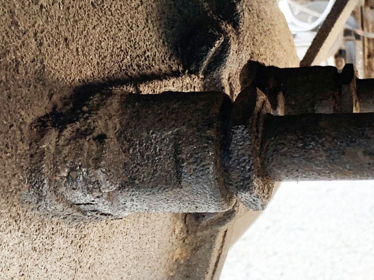

Here's the fitting. What is it and is it replaceable?
 Post subject: Re: Brake Pipe Fittings Question
PostPosted: Mon Jul 11, 2022 5:18 pm
Not Dresser fittings. Looks very much like WABCOSEAL (WABCOTITE may be a similar arrangement). That looks pretty crusty. You might want to consider new flanged fittings and a new piece of pipe. Another method would be a hose assembly from Strato, with the right flanges on each end.

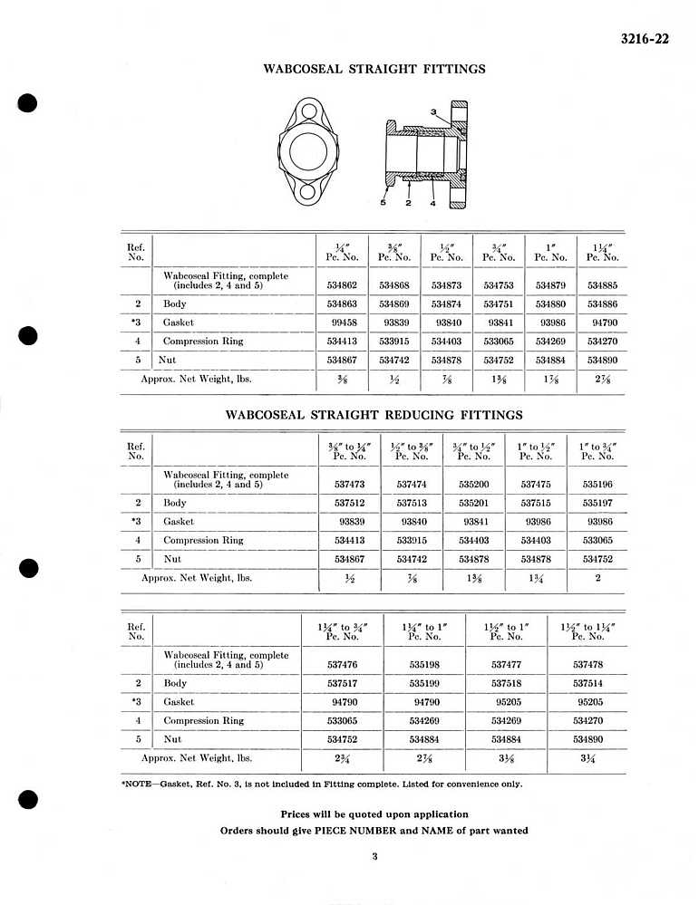

WABCOSEAL, see attached. You will need items 3 and 4 (for 1/2" pipe), which are probably still available from WABCo (in its current iteration). The parts catalogue doesn't list the material, nor does the piece number record. However, these are both probably "rubber goods" (WABCo's term), particularly item 3, and given the age they most likely aren't the white dot formula, which means they will stick to the metal upon disassembly.
If you install new pipes, make sure they have bends like the original (i.e. no pipe elbows). Soaking the threads in turpentine or ATF for a month is advisable before attempting disassembly.
