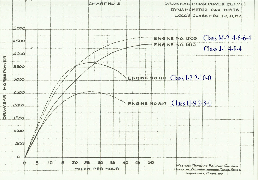

Although Superpower was useful, I am beginning to think it was oversold.
This is the horsepower curves that Western Maryland put together from its runs from Hagerstown to Rutherford in 1947.
It seems that the 2-10-0 was superior to 4-8-4 and 4-6-6-4 in terms of horsepower until about 20-25MPH, and then produces a small benefit, but then at about 40 MPH really starts having an advantage.
My question would be on a road with the nasty grades the WM had, did they really get any value from this, or would an expanded fleet of Decapods, perhaps with an increased firebox and revised valve sizes, timing events, maybe lighter weight rods been the better answer to their needs?

I think you are reading that chart incorrectly. The M-2 and J-1 clearly have superior power output above 40 mph.

The WM route from Hagerstown to Rutherford was WM to Lurgan then RDG to Rutherford. It was not steeply graded and power and crews were pooled. The 2-10-0's were huge, larger than PRR I1sa's. I'm not sure the WM 2-10-0's were capable of 40 mph without pounding the track into submission.
The WM 4-8-4's were apparently based on the RDG 4-8-4's and worked the fast freights between Cumberland and Hagerstown on WM and Hagerstown and Rutherford in a pool with the T-1's. The RDG T-1's worked the trains Rutherford-Allentown/Philadelphia on RDG.
I definitely need an editor upon second read.
I agree with you write; that was my intent.

Adding onto the point about the I-2’s, notice how there’s no data past 40 mph for 1111, or the 2-8-0, which isn’t the case for either the Potomac or the challenger (strong point in favor of super power).. Also, this data was in 1947, meaning the Potomacs at this point weren’t even a year old, so their data might not be as accurate as any of the other 3 classes.
