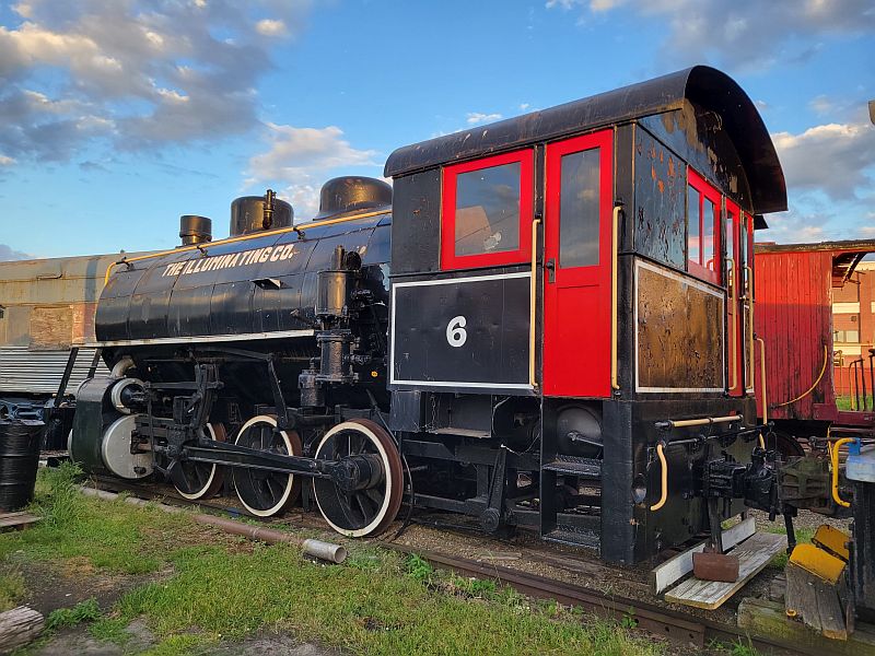

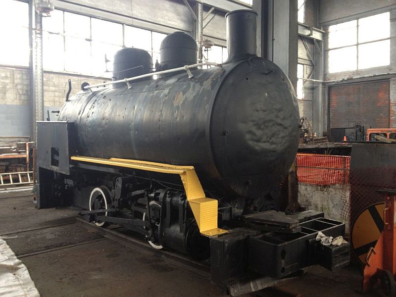

The Niagara Railway Museum in Fort Erie, Ontario has 1 of only 2 true Fireless locomotives in Canada, both of which are in Ontario. Our unit is quite unique being 30" gauge, no cab, built by Porter in July 1943. We had someone come to our opening weekend back in May and tell us we need to get it operating. It has sat outside at a different location since 1984, with little to no care given to it. The previous owners covered holed in the jacket with black duct tape!! The running gear is seized, and some fittings are missing. Plus, it's 30" gauge. If we want to run it, it would have to be off air, and we'd end up with 2ft gauge, 30" gauge and standard gauge. Seeing the video of the Lake Shore fireless operating is neat, something different for show. Would definitely be nice to see a fireless running, but...
File comment: Atlas Steel Welland 30" Porter Fireless.
File comment: Illuminating Company 6 on June 17th 2022.
