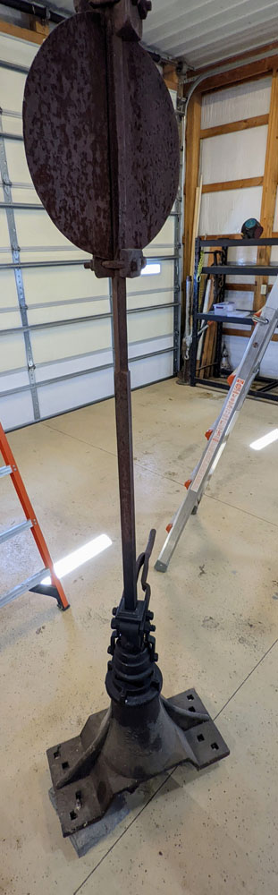

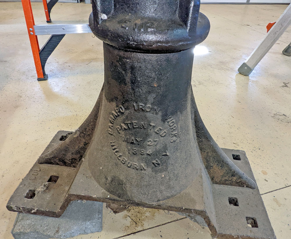

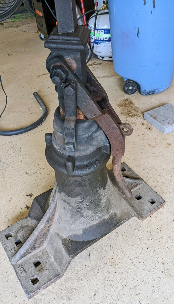

A friend gave me this old Ramapo Iron Works switch stand. It has a cast in patent date of May 27, 1884. I have never seen a switch stand like this in pictures or in person. A friend told me he had seen a very similar stand with 'FRISCO' cast into the base. Unfortunately, this switch stand does not have that in the casting. However, the information I was given is that it is Frisco in heritage. Reportedly, from the now abandoned Beaumont, KS to Enid, OK line.
I have tried to search online for resources on Ramapo switch stands. About the only info I came up with is that they became Racor at some point potentially in the 1930's.
I am looking for any info anyone might have on this style switch stand or other Ramapo switch stands from around this time period.
I realize that there is not a switch stand collectors association to contact and there appears to be little info on the topic in general. Any info that you all may have to share would be appreciated.

this link should give you the issued patent. Found using google patents. https://patentimages.storage.googleapis ... 299176.pdf
lots of other info on Ramapo switch stands by searching "patents.google.com" and entering the search term "Ramapo and switch".

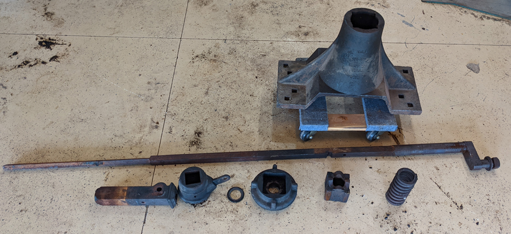

I thought I would post a follow-up. the Patent office filing was very helpful in dissassembling the switch stand. It has taken longer due too the amount of rust and parts that were stuck together very tightly. But I now have them dissassembled and ready to go to bead blasting. The biggest casting will hopefully go to sand blaster sometime early next week. I have attached a photo of the component pieces. I do want to thank all that responded to my initial posting.
