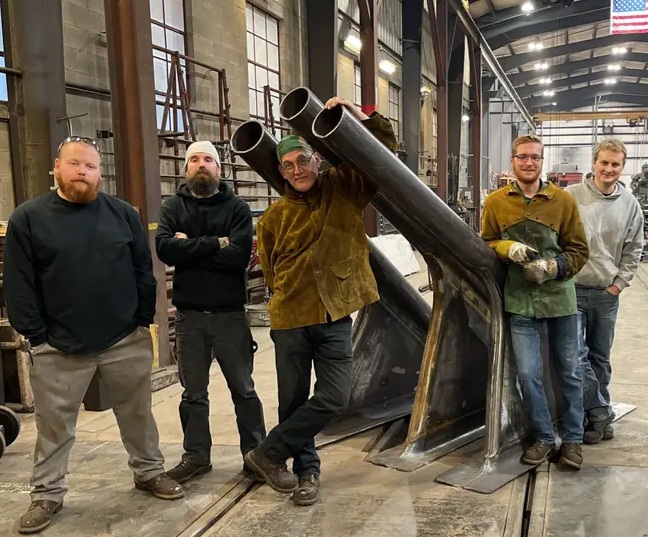

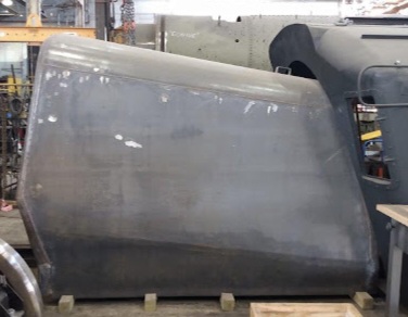

Posts: 219
Overmod wrote:
To my knowledge, the most fignificant work that would be left 'undone' is the physical fabrication of the firebox inner wrapper, attachment of the formed syphons to the crownsheet, and drilling for the staybolting (not necessarily in that order, but requiring care).
Both the new firebox and thermic syphons for 3713 have already been fabricated and shipped to Steamtown. Strasburg made both, a little over a year apart.
The firebox needs all the rivet and staybolt holes located and drilled, the firebox needs installed, and the syphon locations in the firebox need to be layed out, cut, and the syphons welded in, and the staybolt holes located and drilled in those as well.
Still a major amount of work to do, but they have all the main firebox components on hand to begin tackling that, if they want to or have the resources to do so.
-Sam
