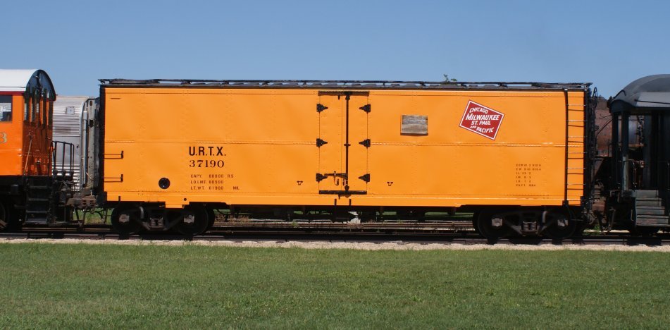

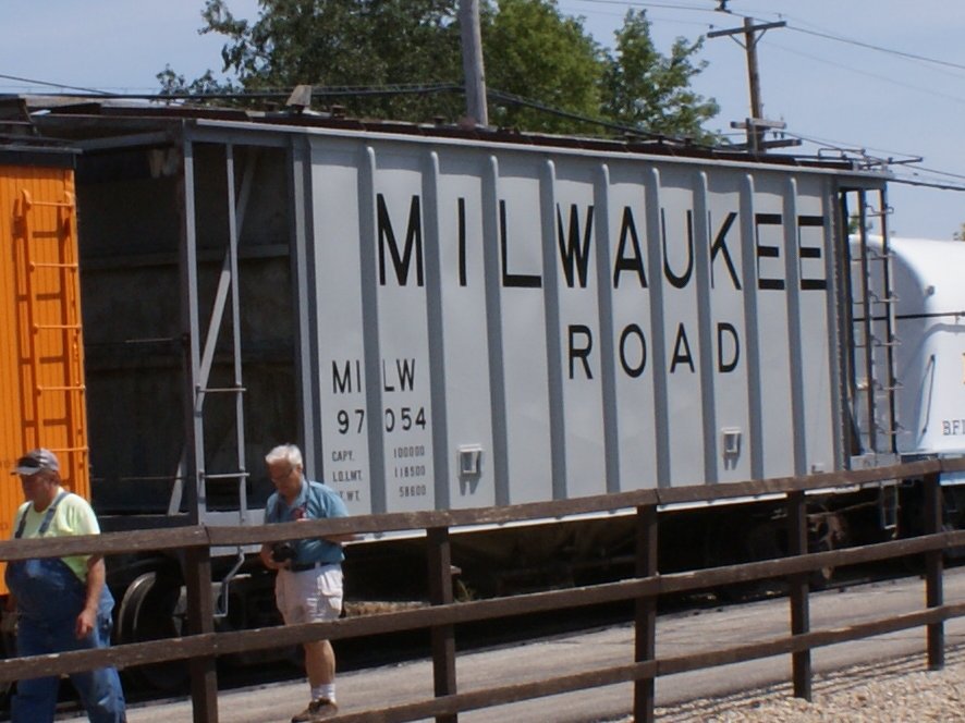

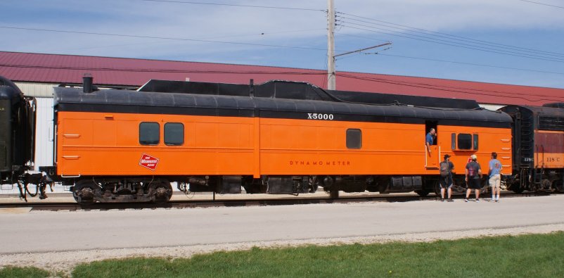

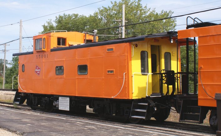

I was in the process of figuring out how to put sash windows back into the IRM’s Milwaukee X-5001 caboose when our General Manager asked if we could repaint it for a visit from the Milwaukee Road Historical Association.
A major effort was put forward by the Steam, Freight, Passenger departments involving about 20 volunteers at one time or another to do four cars. The MILW Dynamometer and the Airslide hopper were completely sandblasted and repainted. The steel reefer and the X-5001 business car were brushed, sanded, then cleaned and top coated. Not all completed but they looked great for the event.

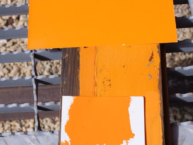

That paint was considered too costly for a quick overcoat for the caboose. And S-W was unable to match the caboose color. We still need to do some major repairs to that car so we went with what worked for around $70 a gallon. That was a custom mix I did, a 50/50 mix of industrial safety yellow and Krylon Farm implement Old Kubota Orange. Sounds strange but it actually worked out very close as per the attached pix. Top is the drift card, mid is an old window sash with two coats of MILW Shops caboose paint, and bottom is my custom mix.

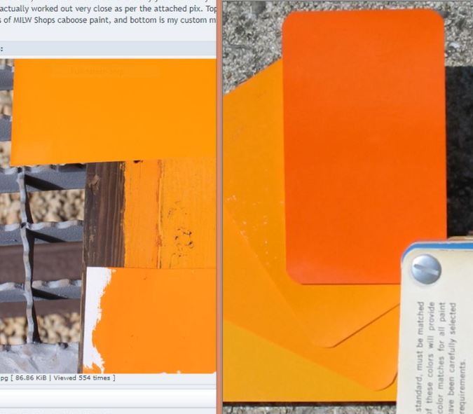

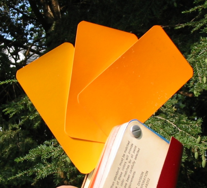

What time of day did you take that picture, Buzz? It's a bit later here in PA now but this is WE5562 Orange, WE5900 Orange, and WE5569 Orange from my Chevy fleet fan deck left to right. WE5562 is extremely close to the color the Northern Pacific Railway Historical Association folks call "Chrome Yellow"...

Around 3 in the afternoon last month. If I want to be accurate I have tried placing a chip chart next to the sample. Using grey scale and standard colors helps but so far photos just do not do a very good job of matching colors, at lest for me.
BTW most of the paint people had excuses for not getting deep orange. New VOC rules, COVID delivery problems, different suppliers for the tints. Even mixing machines that could break if they tried to use the colors we wanted.

Tough call, Buzz, but that one looks like WE5900 from here. I'll have to see what else I can find out about it. There's Mack Truck Orange up on top...
