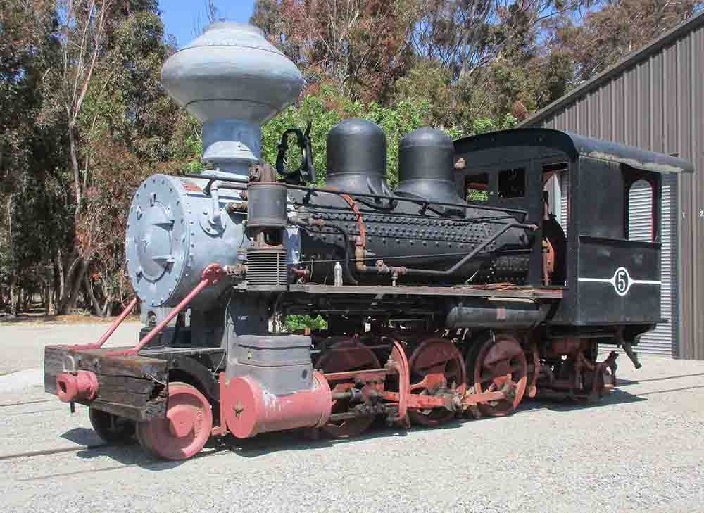

Very Exciting News…Historic narrow gauge steam locomotive Argent #5 arrived this weekend at its new home at Ardenwood Historic Farm! This 26-ton, 2-6-2 (Prairie) steam locomotive was built by Lima Locomotive Works in 1910 for the Williamson & Brown Land and Lumber Company. It was sold in 1916 to the Argent Lumber Company Railroad, Hardeville, South Carolina where it operated until 1956. Since 2013 the locomotive has been on loan to the Nevada County Narrow Gauge Railroad Museum. The locomotive has now been purchased by two individuals and they have leased Argent #5 to SPCRR where it will eventually be operated at Ardenwood.Argent #5 is already close to being operational, but several tasks need to be done first. We need to convert it from burning wood to using oil (burning wood is a fire danger especially since our track runs through a eucalyptus grove); it needs a new tender, and the boiler needs to have lagging and a jacket installed. We expect this work to take about 1-2 years.You can see the locomotive later this year at SPCRR’s annual Rail Fair over the Labor Day weekend, September 3-5, 2022. More information on Rail Fair and how to purchase advanced tickets will be posted on our Facebook page and on our website http://www.spcrr.org.

I’m glad to see this one is going to run again. A narrow gauge Lima rod engine must be a pretty rare beast.
Argent Lumber was an interesting operation; they logged the swamps adjacent to the Savannah River. Every one of the 7 steam locomotives on its property when it closed in 1960 (?) has been preserved.
One crazy factoid about their steam: NONE of the locomotives had a sight glass, they relied solely on the triple cocks to maintain the boiler water level. Yikes.

Argent # 5 did have a sight glass when it ran at the Northern Queen Hotel in Nevada City (after it's boiler was repaired); so at some point one was put back on it. I doubt Lima would have built it without one. Farrell's book mentions that Argent 2-6-0 # 6 blew up in the 1950's, probably due to the lack of one. So much for the good old days being so good, at least in some places ! Yikes !
Be assurred that it will have a sight glass at Ardenwood along with any and all other safety devices needed for safe operation of a pressure vessel and locomotive.

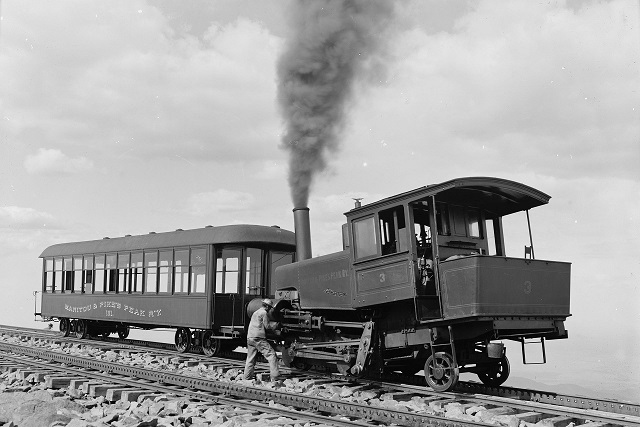

Historically, the cog locomotives on the Manitou and Pikes Peak Ry. in Colorado were not equipped with any water glasses. Various gauge cocks on both sides and the backhead were used by both the engineer and fireman to determine water level. And this was on very steep grades!

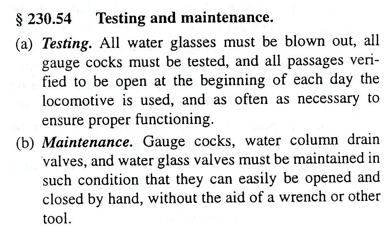

The FRA also expects the gauge cocks to be as functional as the gauge glasses as noted here in 49CFR 230.54:
As an added bit of fun, most but not all boilers have 3 gauge cocks so the term tri-cock is not really accurate. Search both terms sometime...........mld

It is true that try cocks are not required but if they exist they must work, the lowest reading shall not be less than 3 inches above the highest part of the crown sheet and must be tested each day the locomotive is used.
I'll let you argue with the FRA inspector for your jurisdiction as to whether or not they should be on the boiler. Besides, I was merely answering the man's question as to how one would monitor water level with try cocks............mld
