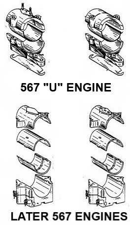

Here is an illustration:
567 "U" on top with only the lower camshaft bearing shells. The cap serves as the upper bearing. Note the bearing shells have no positioning tangs.
Later 567 engines on the bottom, with upper and lower camshaft bearing shells. Note the shells have locating tangs on the sides.
This modification involves taking a lower shell as used on the later engines, and grinding the tangs off the sides to make it fit in the bearing support of the 567 "U" engine.

Looking at the illustration, there’s less meat in the saddle and I wouldn’t trust anyone with a grinding tool on them. With decent maintenance, those bearings should last a very long time. I should think it easier to use a small tool like a Dremel to grind or use a file. The tangs aren’t big.
