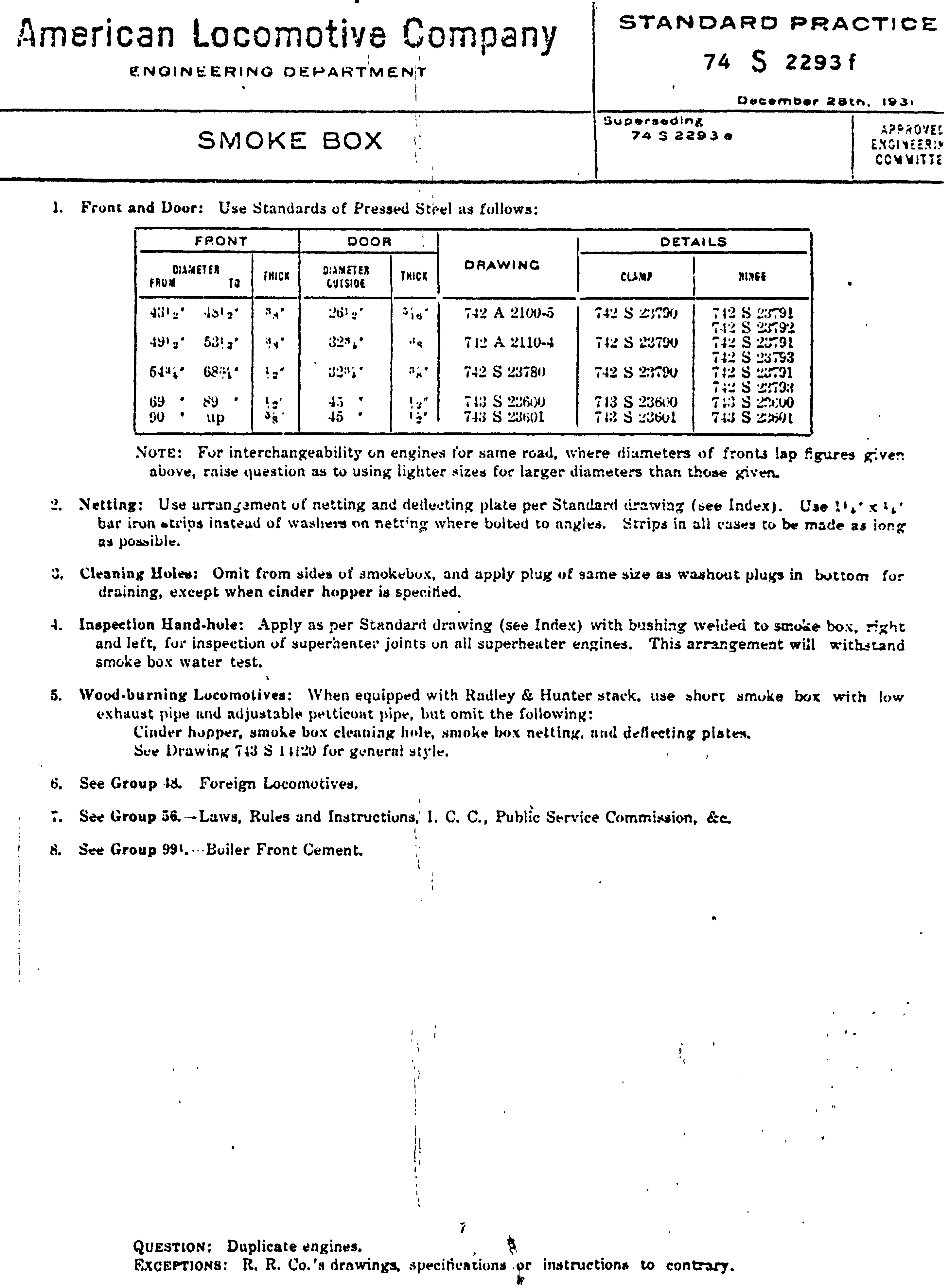

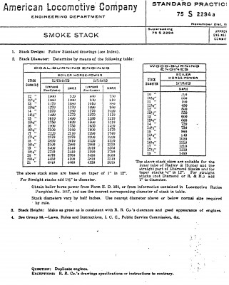

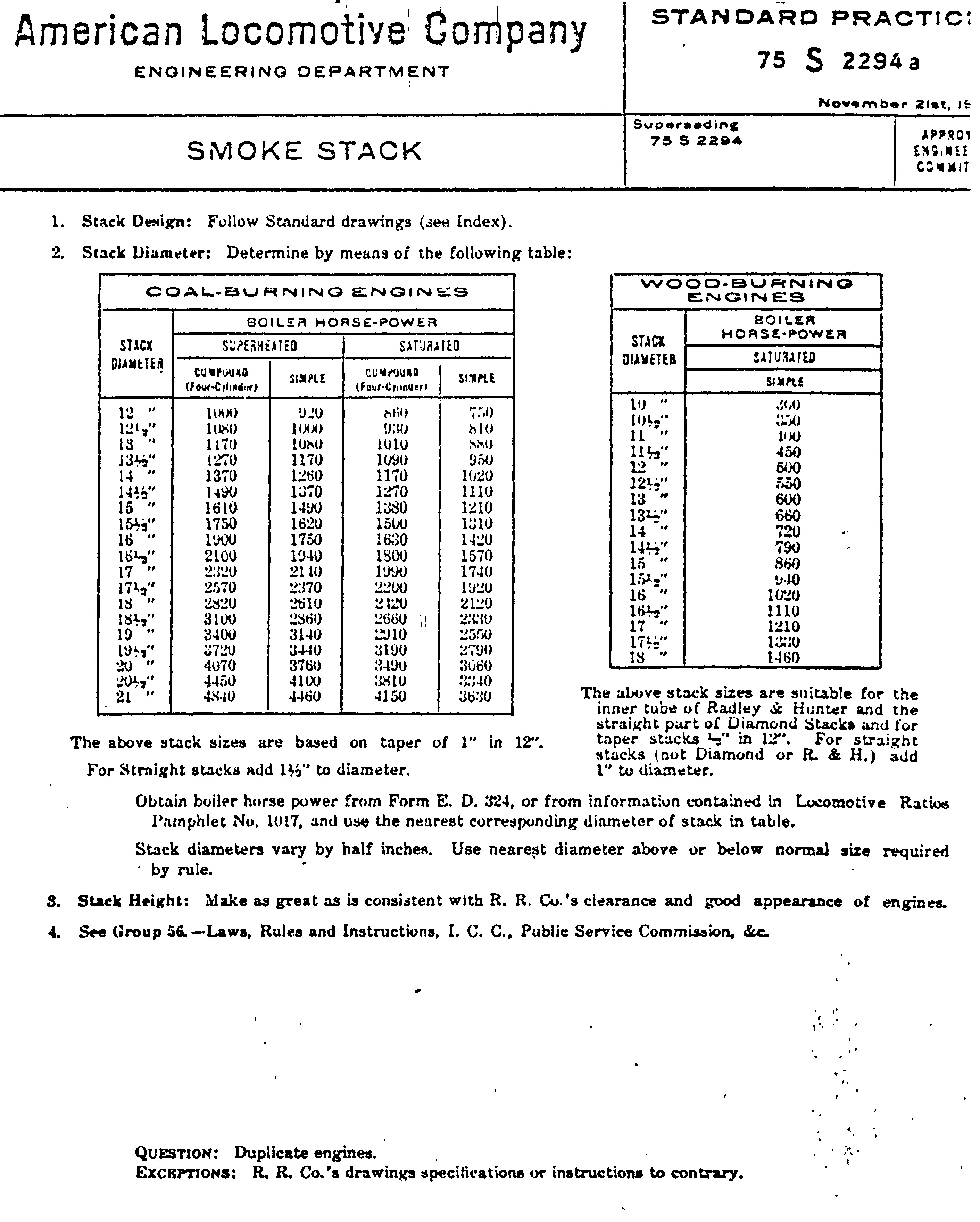

Scranton Yard wrote:
Great work. Is that a plumb bob at the center of the petticoat extension or part of the revised exhaust? Is the current set up similar to how it was originally built by Cooke? Unfortunately, when I made my copy of the ALCO Standard Practice book I neglected to copy 74 (SMOKE BOX Arrangt. & Front) and 75 (SMOKE STACK) so I do not recall if ALCO had guidance for oil-burner front ends in the Standard Practice book. Thank you.
Look what I found!
Cheers!
