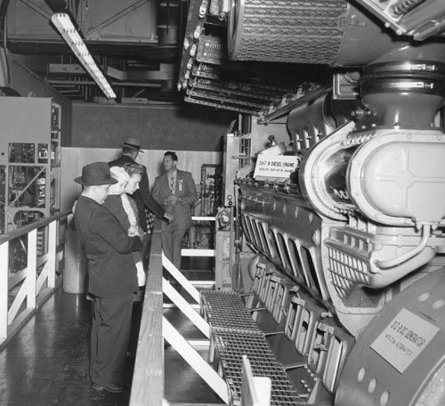

EMD Displays – 567B Training Engine
In 1947 EMD constructed two displays of the complete machinery set of an F3 diesel locomotive. These showed the 16-cylinder 567B engine, D12 main generator, and accessory rack positioned as they would be in the locomotive engine room.
The machinery set pictured below was built for the 1947 EMD Training Center, located in the southwest corner of the plant. It was displayed with the engine cooling fan and radiator hatch, and the locomotive dynamic brake hatch, hung in their proper location above the machinery, suspended by steel rods from the ceiling. This was basically the locomotive machinery set without the carbody.
The Training Center machinery set had a 567C engine replace the 567B after 1953. It was further modified with a 567D3A engine around 1964 and the F-unit roof hatches were removed. It was later equipped with a 645E3 engine and AR10 traction alternator in 1966. The machinery set remained in the Training Center until its replacement by a new Training Facility in the 1990s.

No wonder EMD dominated the postwar diesel market with sales aids like these. Plus they could win over a reluctant master mechanic.
Of course it helped that EMD's were the most reliable, too.
