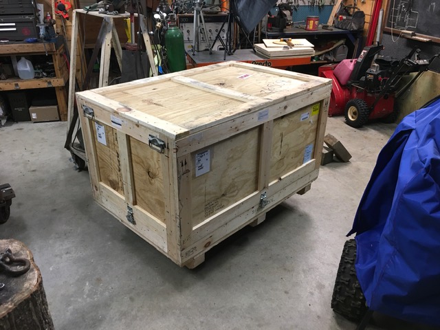

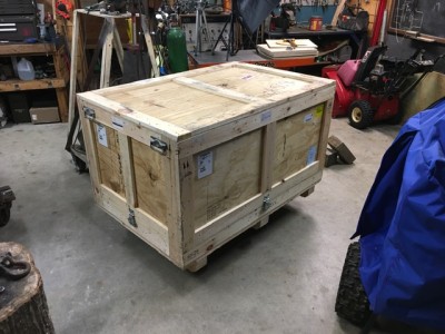

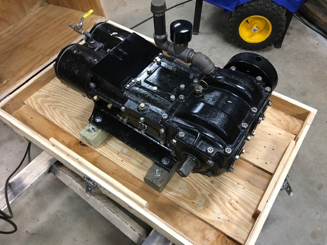

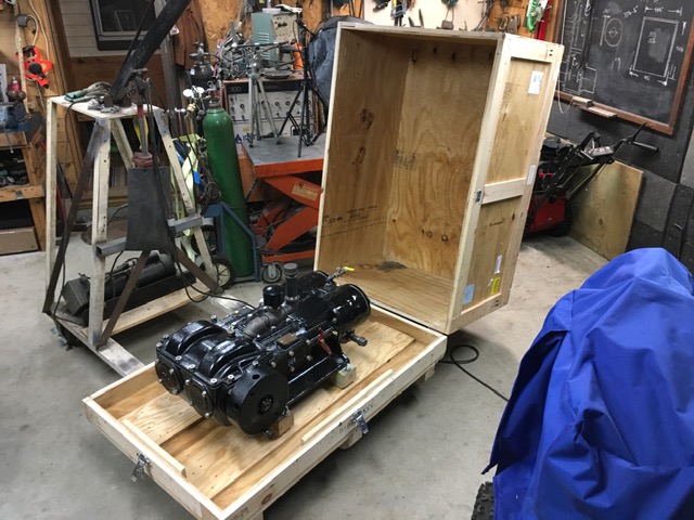

Thought you might like to see the custom reworked shipping/storage/display crate I put together for the stoker engine. Should keep it safe but still easy to peek at.
Probably not many “new” in the crate steam stoker engines out there.
Can now be put in the giant warehouse with Indies Ark. It is after all an ex military hardware crate for F35 JSF fighter bits…..

Lends a whole new meaning to the phrase, "crate motor." I hate to think of it getting covered with ash and grease, but ultimately that's the whole point.
The Standard Stoker motor for PM 1225 was given a slapdash cleanout in the 1970s and ran for years thereafter, but a couple years ago our Master of Fussy Projects Jeff Lis went over it thoroughly and it now runs smoothly. But we don't have any sexy videos.
