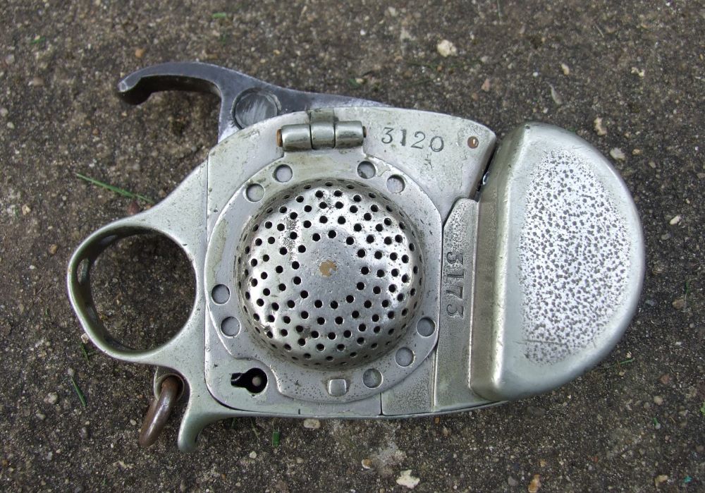

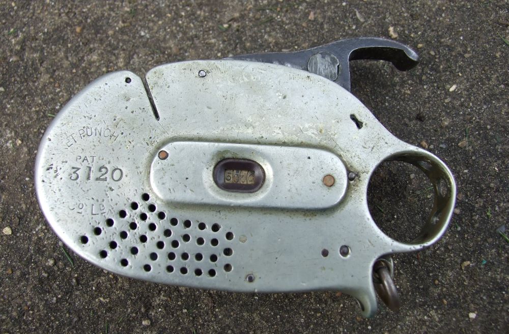

 Post subject: Re: Mystery: Streetcar Fare Collector ca 1890?
PostPosted: Wed Feb 09, 2022 7:00 am
Posts: 669
Location: Ipswich, UK
This is the one that I have, and seems a similar principle to the Washington one.
Measures roughly 5" x 3"......
Register is on the rear with rotating brass dials.
Hand grip operated punch, which sounds a bell when activated. It won't work without a ticket inserted in the slot either.
The punched parts of the tickets are collected in the raised area at the right hand end of the upper view and this is (nominally) secured by the lifting area encosing the bell, which was released by a key, presumably held back at the depot.
I found a metal box containing the remains of a number of these punches in the loft at work getting on for 40 years ago and I think, from memory, we were able to assemble 4 or 5 working examples from these parts, which explains why there are different serial numbers stamped into the punch itself and the removable punched-ticket collector lid!
