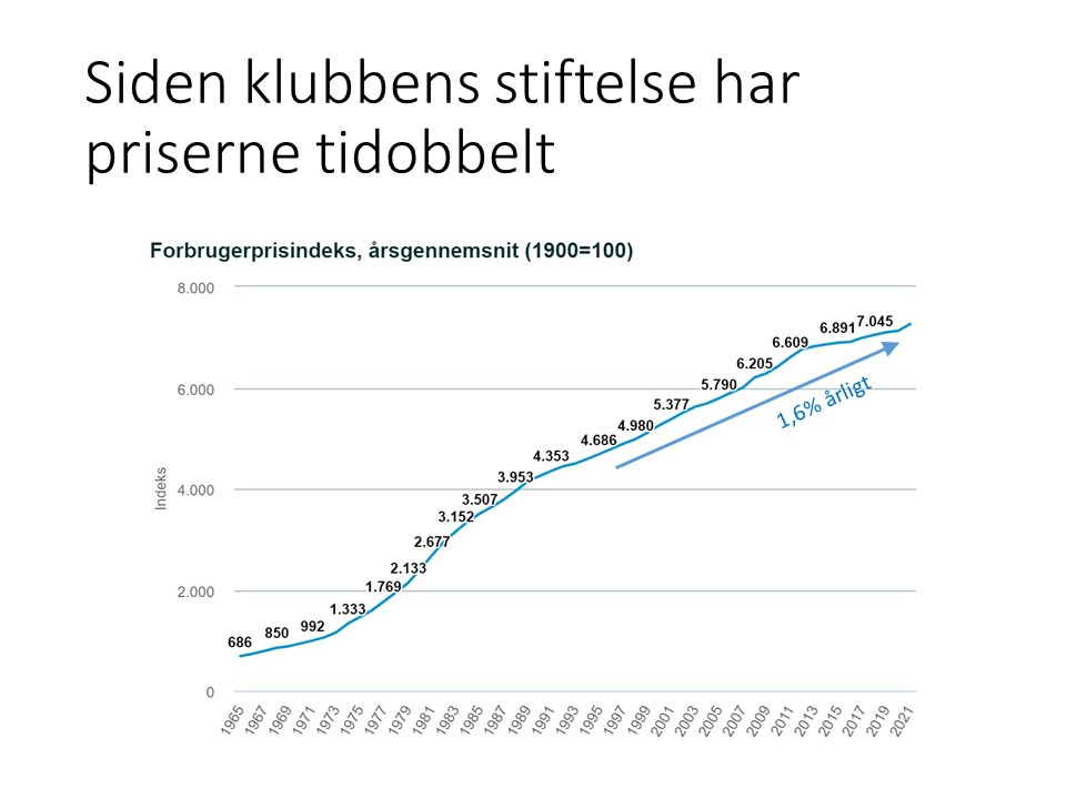

I am making progress on my presentation and have this slide. It is from Danish government statistics. It says, "since the clubs founding (1968) prices have increased 10x". In the years since 1998, the annual increase has been 1.6%.
And that is not including how steam work is harder because so many resources are no longer industry standard.
