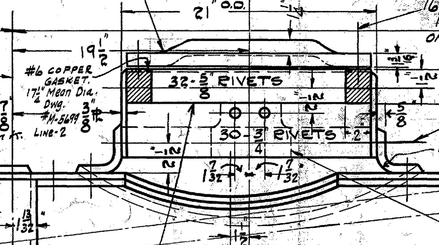

I was under the impression that heavy gauge copper wire is an appropriate gasket for a steam dome. All three of our J&L Porters have such gaskets and on the 58 the original gasket was in such good shape that after annealing it, I put it back on the boiler.
Even our boiler drawing calls out a No. 6 (I assume 6 AWG) gasket.

Rick, copper gaskets are a standard for domes. If I'm reading what was stated correctly
...nothing more than some heavy gauge copper wire wound around the studs.
It sounds as if it was not a single copper gasket "hoop" laid on/in the gasket groove, but passing around the studs in some fashion, which would not create anything near a proper seal. Almost sounds as if someone with no idea was told to "put a gasket in and seal the dome" and figured it out as best as they could. Reminds me a little of this:

OK that makes much more sense. Putting wire around the studs is so out of the ordinary that it didn't even compute to my brain as a possibility!
