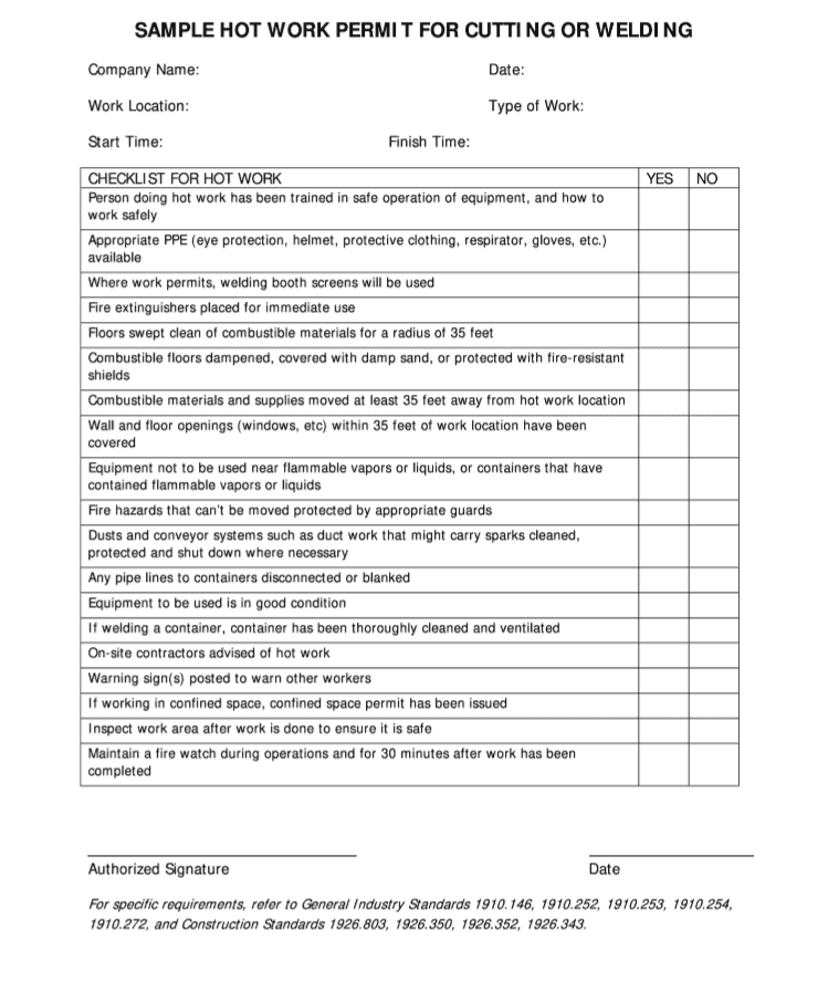

Having a Hot Work Permit program to enforce outside of a pre-set "hot work area" (which could be the shop or part of the shop) can save lots of grief. It's a simple checklist, numerous examples you can use online. Basic questions, you can stop and rethink as you fill out the form.
-Is a fire extinguisher present?
-Do you have a person on hand to fire watch?
-Are all flammables removed from the area, and those that can't be wet down and/or covered with a fire blanket?
-Fire watch period after hot work is complete? (In my experience usually a half hour, although in more flammable environments an hour or more)
-Did a supervisor double check above?
It may seem excessive until you need it. As exampled in this situation- that wood that's been drying out for decades or is covered in grease and grime can go up before you can react.
This example below may be more in depth or strict than need be, but any iteration with the basic safety checks is better than nothing. Especially helpful for those who might not do hot work frequently- and even for those who do and can just as easily overlook or forget.
-Sam

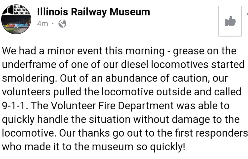

And in case anyone needs another reason to take another look at your hot work and fire-protection policies:
I don't have any information or knowledge of how it began, other than grease on the frame of an engine was smoldering, and after initial attempts at extinguishing failed, the fire department was called, and the unit was moved outside the building. This was all caught on one of the IRM's live camera feeds.
Alco/Ingersol Rand boxcab DL&W 3001.
