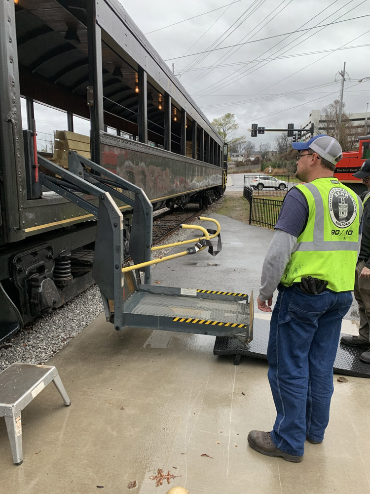

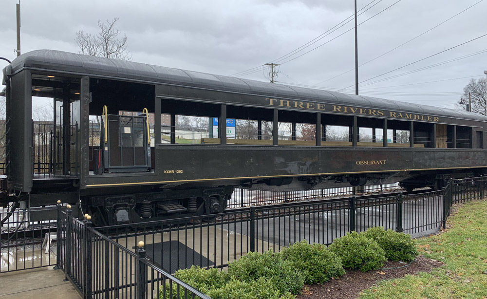

When I stopped by the Three Rivers Rambler in Knoxville, TN, three years ago, they had just completed their new open car "Observant" which features a built-in wheelchair lift.
- Alan Maples
Three Rivers Rambler Knoxville TN 12152018 wheelchair lift Alan Maples photo.jpg
Three Rivers Rambler Knoxville TN 12152018 wheelchair lift Alan Maples photo.jpg [ 248.25 KiB | Viewed 5787 times ]
Three Rivers Rambler Knoxville TN 12152018 Alan Maples photo.jpg [ 226.29 KiB | Viewed 5787 times ]
