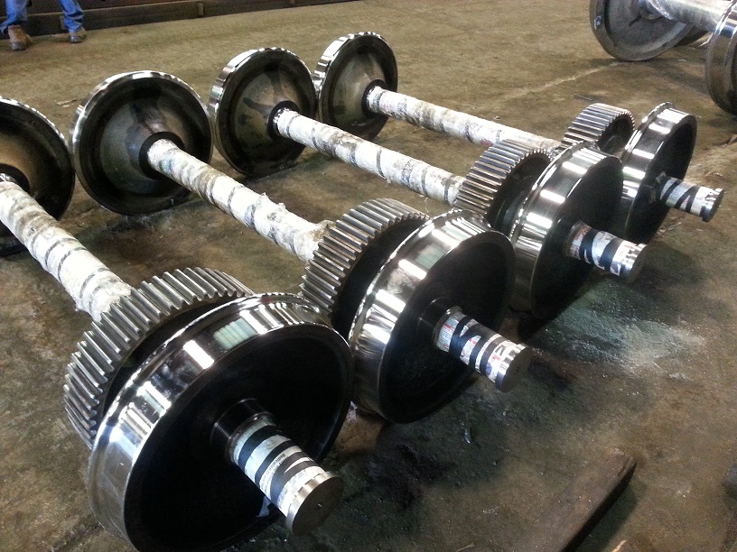

Posts: 222
Location: Pittsburgh
You might consider Lyons Industries, Ebensburg, PA
http://www.lyonsind.com/rail_trucks/index.html
They've done several complete trolley truck rebuilds for us. On the last project, Lyons did some pretty amazing work, especially considering the miserable shape of the old trucks we sent them. We did need to do a fair amount of "dealer prep" on the brake rigging before the trucks were ready to go back under the car, but the wheel & axle work (new axles, re-profiled wheels) was top notch.
/s/ Larry
Lawrence G. Lovejoy, P.E.
