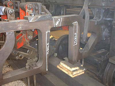

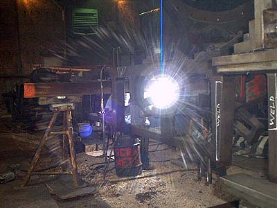

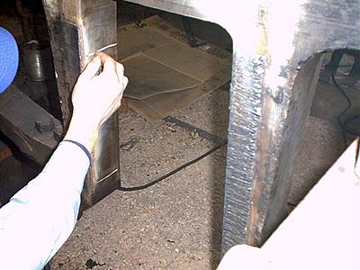

Back in early 1990s I rejoined Mid Continent and the then "steam team" were deep into disassembling the Western Coal and Coke #1. The frame was totally accessible which was wonderful as you seldom get to work on the frame of a small 50 ton engine without all the attachments and appendages getting in your way. In this case the frame was extremely gouged and worn from its whole life of running loose and worn out. I do not have pictures of what it started as but the condition of the jaw bearing surfaces were the worse I ever saw. Guess this has nothing to do with renting or borrowing a machine to assist in getting things straight again.
I ended up doing the whole frame by welding and grinding by hand. It was a PIA to do it that way and I dreamed many nights of a better way to approach this repair. Even if I had found one the cost was prohibitive. So not knowing any better I went at it the only way I knew how with the tools I knew how to use. It took me approx 8 hrs to weld and grind each jaw. That was a very solid 8 hrs of my nose to the grind stone {no pun intended} but I could usually get one jaw finished per day I spent down at MC. I burned a lot of rod and then took most of it off with a grinder. I found using a grinding "cup stone" worked so much better and faster than using a "cutting wheel" disc that most people associate with grinding. It soon became trained monkey work as I got better at it. Seriously dull work. You probably saw my work at MC in your visits over the years as not much has been done to the locomotive in the last 20 yrs. The contractor who was working on it said when he began to tram the frame that the ground surfaces were within .001-.008. He thought he was going to have to grind it into tram but it had already been done. Not saying any of this to toot my own horn. I am saying that yes it is a lot of work but the money saved doing it the old fashioned way is a legit option. I would not be afraid to do it that way again. But having the frame stripped down to bare frame made the job much easier. Using a cup stone like a Blanchard Grinder makes for a nice job. It is not rocket science but I suppose finding someone to do that mind numbing work might be a challenge. Wish you luck in finding a fast and easy way to do it. As I said, I dreamed of a milling cutter zipping up and down getting it done so much easier and faster. I did all three surfaces of the jaw which were all gouged and worn using a square and straight edge. Like body work the old fashioned way you just keep taking off and putting on where you need it. I was a fairly good welder already so that part was old hat. If I were an active contractor who did this kind of work I think the portable machine would be the ticket. A very talented mechanic/machinist I think could come up with something that would work. As far as being able to do all three wear surfaces with one machine would be quite a great accomplishment in my book. Probably so dirt simple I would be embarrassed. Good luck on the hunt for this better mousetrap. Sure wish I had found it. On the other hand some jobs just stink so you go do it and hope you don't have to do it often or again.
Thinking over the job that I did, I didn't have to poor the coals on like I did. But I just wanted to get it over with. For me if I allow myself to go slow and come back to it a little at a time I run the risk on not coming back to it at all. I say this as I mentioned it took about 8-9 hrs per jaw to do that work. The people in the shop didn't like me welding and smoking up the shop like I did {winter time} or the noise and dust from the grinding. But they got over it. Unrelated, I was working on a similar project in a round house in MN. I just couldn't believe the people who had shit fits that I was welding 3 stalls away. They acted like the flash was going to permanently blind them and the smoke was going to kill them. If you want to work in a RR shop environment but on your big girl panties. RR shops are not your model railroading basements. This rant has bothered me for some time and guess it just now comes out. Kind of PTSD thing.
Dennis I know you know your stuff and hope I didn't go off the deep end responding like this? I included some old pictures from WC&C #1 project. This might give some insight to what were talking about with "jaws" and finding an easier way to square things up other than an air grinder and cup stone. I have seen some jigs/fixtures that could clamp on to a frame side but I have not seen anything that really did a better job and was that much faster? The contractor who was tramming the frame used a swing arm arrangement with a grinder but stopped as there was no need to do so. Also I have not seen all there is to be seen in this world so keep us informed if you find the answer Regards, John.
