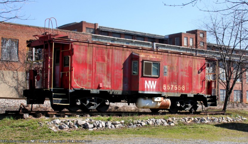

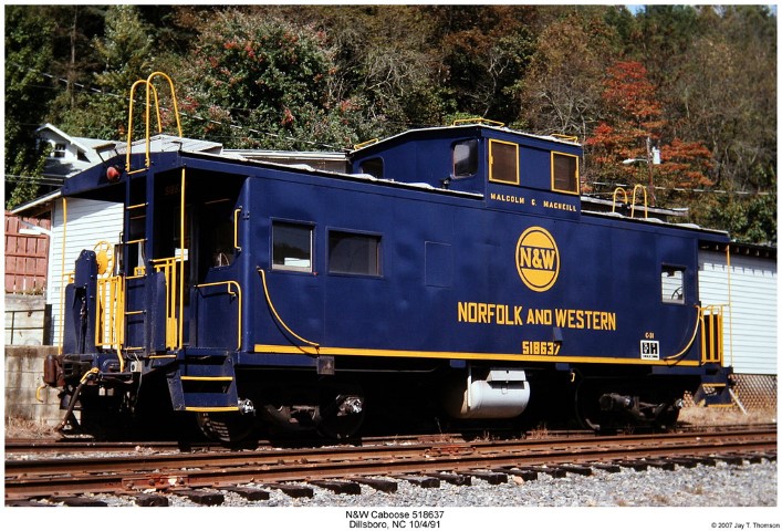

This is what I have in mind:
A large, non-removable, heavy-duty tank. Anyone have any information or recommendations?

First thing that comes to mind would be a semi-trailer reefer propane tank.
I have only seen one passenger car with a permanent propane tank and that
was a Canadian car.
-Hudson

My thought would be to contact a propane company. Dileo Gas is up near me, they might be a good source of information and usually when I have a customer with propane questions I refer them to Dileo. If I knew more about propane tanks other than it's a propane tank I could offer more. My only question is how common propane tanks like this are anymore? I don't see many trucks that come through my office that use propane for stuff on the truck itself.

The Waukesha multi bottle gas lockers were designed for bottles that would be removed from the car for filling and had to be light enough for manual handling. That doesn't make a lot of sense these days when you can get propane delivered via truck most anywhere. I second the idea that tanks rated for use on highway trailers should be good, UNLESS the FRA has a more stringent specification, which is, I think, the original question.

The propane tanks pictured provided fuel for the caboose stove and a propane-powered refrigerator. Generator was belt-driven off an axle, at least on the car I'm familiar with.
