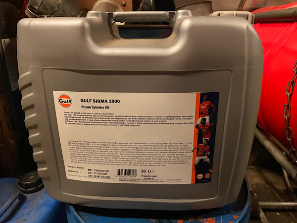

File comment: This is our saturated oil

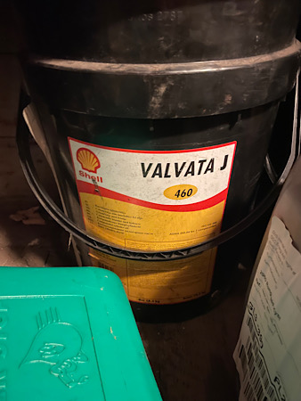

File comment: This is our superheated oil

Thanks so much. Will anyone dare say anything specific about the oil in the photos?

This is not useful at all, but I was curious that Gulf Oil was still being sold as they disappeared in the 1980s (growing up in the early seventies my tiny little town had a Gulf station), I found out that in Europe Gulf Oil products are licensed to this group: https://www.hindujagroup.com/ Gulf Oil was one of the so-called Seven Sisters oil companies, and is the origin of the Mellon family fortune, including Mellon Bank and the current Pan-Am Railroad.

Never seen them in use in the USA and know nothing about them.
