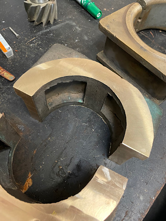

Author:  softwerkslex [ Sun Nov 14, 2021 5:39 pm ]
Post subject:  Re: Design types of coupling rod bearings
Stuart didn't have time, so I am posting the side rod bearing photos from HHB 4.
File comment: Close up of bearing half - original.
File comment: New bearing from casting - in progress.
File comment: The assembled bearing showing the babbit as pockets in the bronze - original.
Author:  hadder [ Mon Nov 15, 2021 2:36 pm ]
Thanks for posting the photos. I've never seen a babbit pocket before.
Eric
Author:  Dave [ Mon Nov 15, 2021 4:00 pm ]
Wondering if perhaps the original design was for oil lubricated pins and waste was where the babbit is now? Probably overthinking but I cant seem to come up with a rationale for the current design. Just happy it seems to work well in service.
