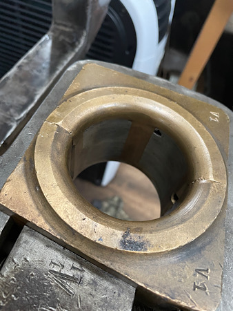

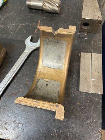

Stuart didn't have time, so I am posting the side rod bearing photos from HHB 4.
File comment: Close up of bearing half - original.

File comment: New bearing from casting - in progress.
File comment: The assembled bearing showing the babbit as pockets in the bronze - original.

Thanks for posting the photos. I've never seen a babbit pocket before.
Eric
