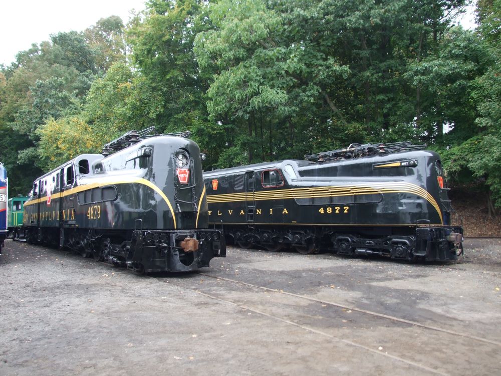

...or the URHS of New Jersey as they externally restored a pair of GG1s back in 2014....

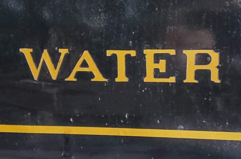

Yes, dark green 5 stripe. Here is a better photo link
https://www.irm.org/gallery/PRR4927/aaa
The attached is the close up of the one water note that was done, why only one I do not know.

Buzz - That looks like a standard PRR lettering set. I’ll look through my stuff and see if I have that set drawing.
If not, contact Pennsylvania Railroad Technical & Historical Society, Lewistown Station & Archives: http://www.prrths.com/newprr_files/newPRRLewistownArchives.htm

I believe the PRR used “Craw Clarendon” font.

That’s a common misconception. Their lettering does have a few similarities with the Clarendon family of typefaces. But, like most large corporations, PRR had its own proprietary lettering styles. It’s a from of branding. PRR had standard diagrams for painting/lettering almost everything and those referred to standard lettering sets by drawing number.
I’ll look today if I have that particular set drawing but don’t hold your breath….

According to this website Craw Clarendon was not developed until the mid-1950s.
https://fontsinuse.com/typefaces/7384/craw-clarendon
The “water” sample in the photo above appears to have more in common with Railroad Roman than it does with the Clarendon family.

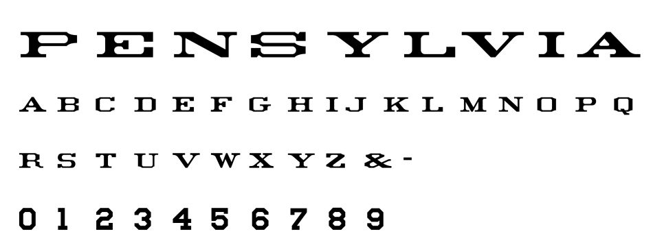

I haven't located the source drawing, should be on a computer around here somewhere, but I do have handy the vector artwork traced from the original drawing that matches the images. The vector art can be used to make adhesive stencils or adhesive vinyl lettering. Let me know if you are interested and I can send either a high resolution JPG image as an example or the exact sized layout if you prefer that in PDF, EPS or AI format.

Jarod, tried contacting you off list but I don't know if it went through.
Yes please send the vector artwork, AI file should work well for me.
Thanks for all the help.
