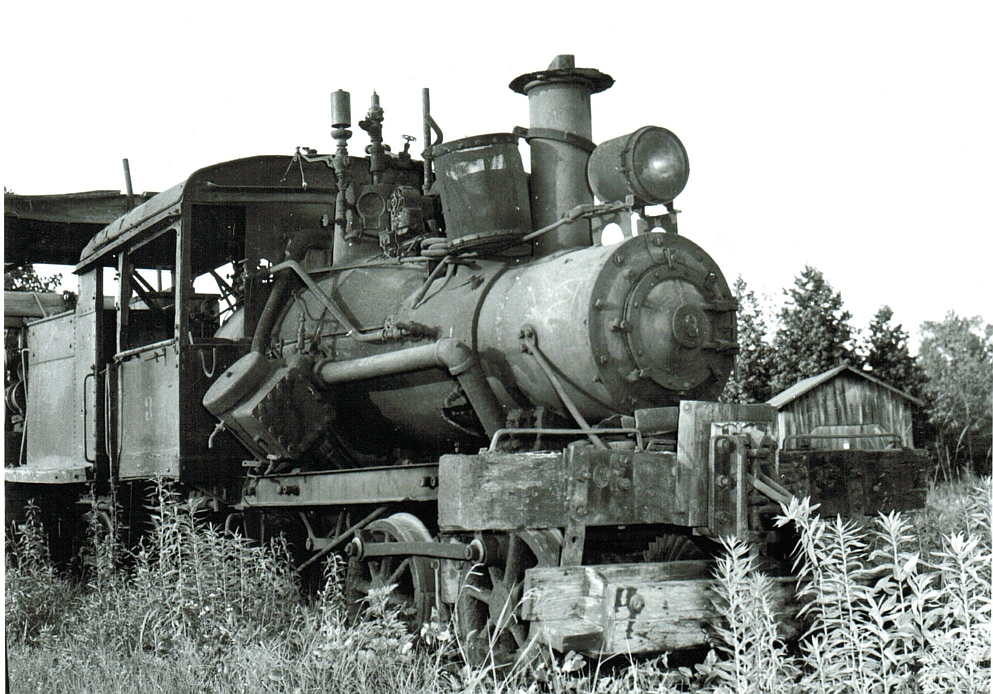

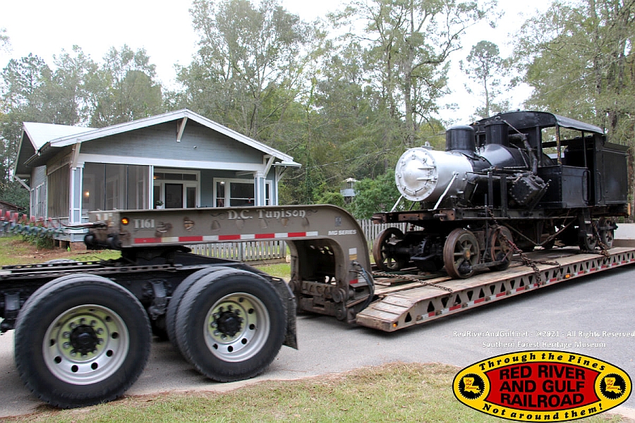

Former Santee River Lumber Company Heisler #3 arrived yesterday at the Southern Forest Heritage Museum, Long Leaf, LA on October 20. Owned by Mike Brown of Crown Point, LA, cafefully cared for by Mike and stored at the Whitewater Valley RR in Connerville, IN, the locomotive will be the first steam locomotive overhauled in the Red River and Gulf RR / Crowell & Spencer Lumber Co. shop in Long Leaf since 1951.
File comment: #3 stored at St. Stephen, SC in the 1950's, from Mallory Hope Ferrell

File comment: #3 arrives at Long Leaf, LA

The location for the first photo should be St. Stephen, SC, where Santee River Hardwood was located. (There’s no Stephenville in SC.)
Tom Fetters’ book “Logging Railroads of South Carolina “ has some great photos of their locomotives and operations.
