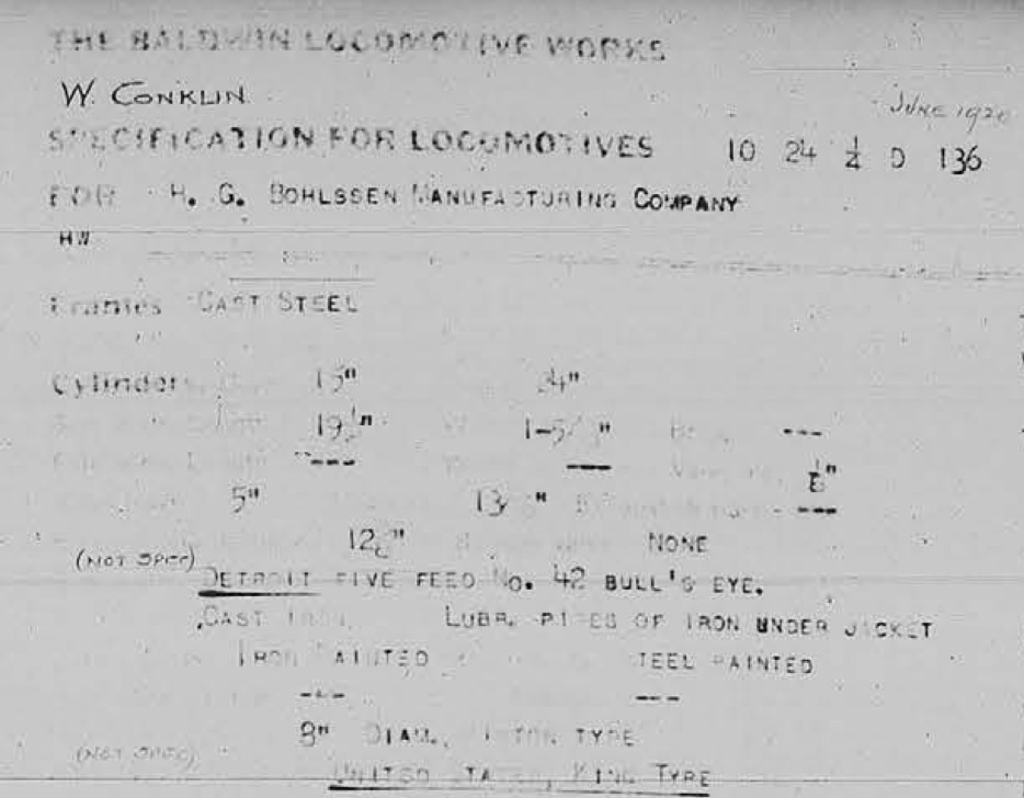

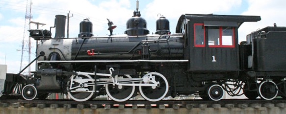

Today I browsed some 20 year old photos made at the Galveston RR Museum.
Engine in question is
Waco, Beaumont, Trinity & Sabine RR #1 a Baldwin 2-6-2
I can NOT trace any of the available info about this engine back to the original/first owner/operator
of this locomotive. I did NOT find any matching info in my Baldwin data.
Does anyone have the class designation/line number of that engine that I can trace back within Baldwin records?
If the cylinder-diameter at steamlocomotive . info is correct it should look like this:
10-24-1/4-D,xxx
Or maybe someone can match the supposed serial number 53413 to the line number?
https://www.steamlocomotive.info/vlocom ... splay=1173
http://wbtsrailway.net/photos.htm

Allen,
yes that is what I have - ALL databases from SMU - but nowhere to find this loco!
That is the reason I asked here.
You know the data is all based on class not serial number.
Also Wes Barris site did not list it!
And yes I have the info from Dougs site with the first owner name "H.G. Bohlssen Co. #1".
But nothing of "Bohlssen" "Bohlsen" "Bolsen" "Bohlsson" "Bohlson" "Bolson" etc is to find in
the DeGolyer data!
And I checked not only the 10-24, I checked also the 10-22 and 10-26 in case somebody had the the cylinder diameter false.

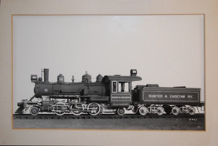

The BLW classification covers some rather different locomotives: the 2-6-2 in question, #1, has piston valves (superheated?) and asymmetrical driver axle spacing.
This locomotive is 10-24 ¼ -D-160. Slide valves, symmetrical driver axle spacing. Built for Allison Lumber Co., owner of the S&C.
Some locomotives in the 10-24 ¼ -D class had larger diameter boilers, some tapered and some straight.
Seems like a very strange "classification" system....

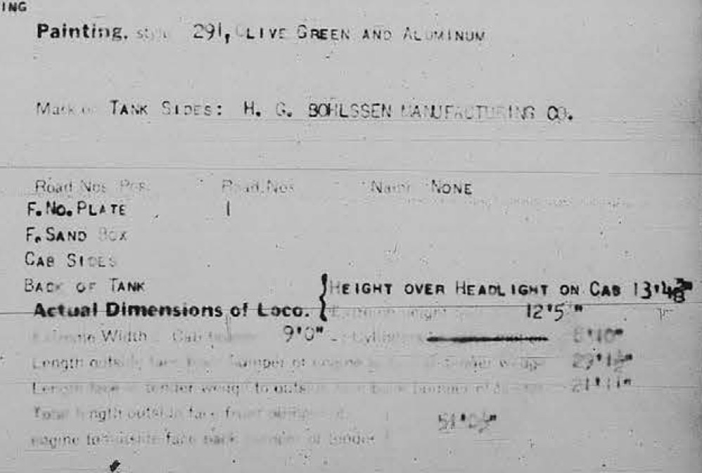

My problem is that I have no access to the construstion number list.
I have only the SMU public available records and as you mention in the index this one is missing.
I then checked the most logical 62, 65 and 71 but not find it.
Thanks to Brian Norden I found it in 65. My fault that I not found before.
Yes it is 10-24-1/4-D,136.
That pages are very very very light scans - almost unreadable. That maybe the reason this engine
is not listed on Wes Barris database.
Again thanks to all for help!
