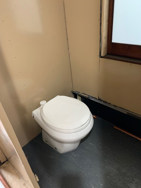

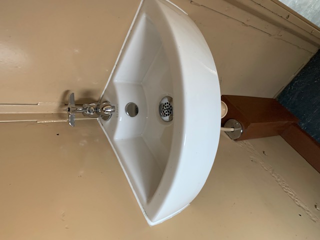

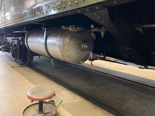

We are installing "Headhunter" brand flush toilets in our CNJ coaches. These are primarily sold for marine use. We needed to have water tanks and holding tanks fabricated as the CNJ cars had no running water system of any kind. The water tanks are pressurized off the trainline air pretty much the same as old style water raising systems.
Since we have running water, we added a small corner sink.
Once everything is trimmed out, the result is a nice clean and functional restroom facility that passengers seem to appreciate.
http://www.headhunterinc.com
- Alan Maples
Everett Railroad

Alan,
Did these cars have a bathroom or did you add them? If it did have a bathroom did it originally have a sink that was missing or did you "upgrade" a bathroom that was essentially a hole in the floor and nothing else?
 Post subject: Re: Passenger Car Toilets
PostPosted: Sat Aug 07, 2021 7:59 pm
Posts: 720
Location: Scottsboro, AL
diningcartim wrote:
- Alan Maples
Everett Railroad
Alan,
The CNJ coaches had the basic "dry hopper" arrangement without a sink. We essentially started over and salvaged only the restroom door and door frame.
- Alan Maples
Everett Railroad
