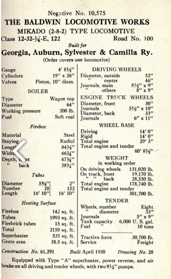

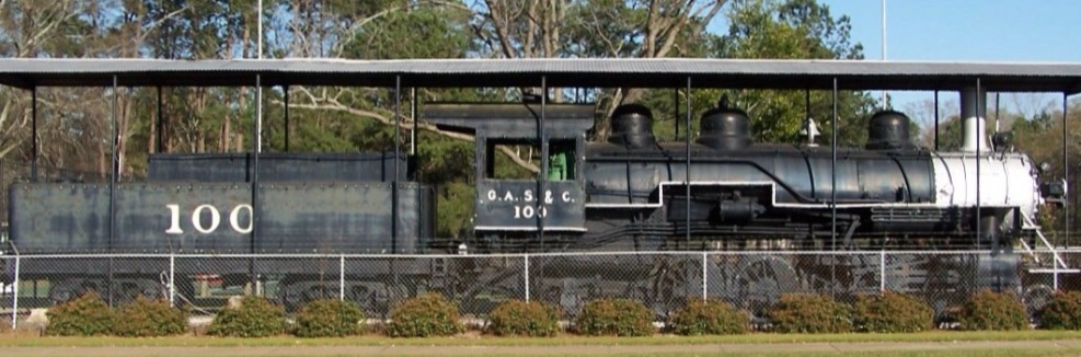

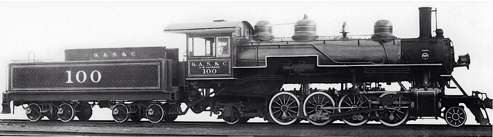

Maybe 20 years ago surprisingly I see this 2-8-2 in Sylvester, GA.
As my interest at that time was only geared locomotives I took a couple pics and drive away.
Recently I found the Baldwin paster on this and I must say for a Mikado this was a really beauty new.
Nice proportions, polished steel boiler jacket, outstanding lining for a 1930 make.
A quick internet search showed that they build a new shed and give some paint.
See e.g. here:
https://www.rgusrail.com/gagasc100.html

Yes Sierra #34 and Bonhomie & Hattiesburg Southern #300 are the same class plus Santa Maria Valley #21 too.
Here the main differences:
B&HS #300: 12-32-1/4-E,94 - EWT 68" 200lbs Boiler, 13' tubes, 52" drivers
display Hattiesburg, MS
Santa Maria Valley #21: 12-32-1/4-E,107 - EWT 64" 200lbs Boiler*, 16'10" tubes, 50" drivers
restoration Astoria, OR *not superheated!
Sierra Railway #34: 12-32-1/4-E,116 - EWT 66" 190lbs Boiler, 16'6" tubes, 46" drivers
stored Jamestown, CA
G.A.S.&C. #100: 12-32-1/4-E,122 - EWT 64" 200lbs Boiler, 16'10" tubes, 52" drivers
display Sylvester, GA

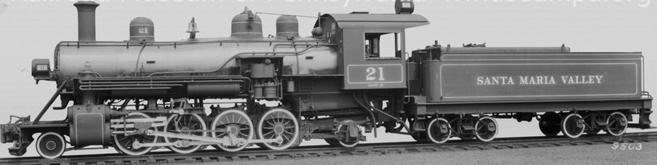

Good day, your comments on two of these locomotives prompt me to answer.
In reverse order, I can tell you that Sierra Railway 34 was built and did operate at 200 lbs.
About Santa Maria Valley 21 not being superheated, I just checked my in-service slides
and indeed, they do not show either a superheater plate or the 5 bolts that support the header. However, further scrutiny shows that the smokebox was insulated, an unusual feature, but that could have covered these features up.
I just cannot see a piston valve locomotive at that modern date being built without superheat for the SMV. Just about everything else on the roster had it. It is possible though. Quincy RR 2 now at Niles Canyon has piston valves, but lacks superheat.
You have brought up a good point that needs further exploration.
 Post subject: Re: A beauty down in Georgia
PostPosted: Sun Sep 05, 2021 9:12 am
Posts: 462
I couldn't leave this alone & remembered that I have a builders photo of 21 in a yellow Kodak 8x10 box.
It sure looks like 21 was built that way. The one thing that still causes me to question this is the seam that separates the boiler from smokebox looks to be of the same diameter and the smokebox still looks like it could be insulated. Why would that be?
Wow, ordered that way from Baldwin. SMV did not have grades of any real consequence,
so I could see where an accountant could have suggested to omit superheat to save initial capital expense. Would like to see the correspondence when she was ordered. That would explain a lot.

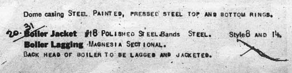

PostPosted: Mon Sep 06, 2021 3:55 am
Posts: 268
Good Morning Tom.
Seems like you have as much time researching for our hobby as I do.
Thank you.

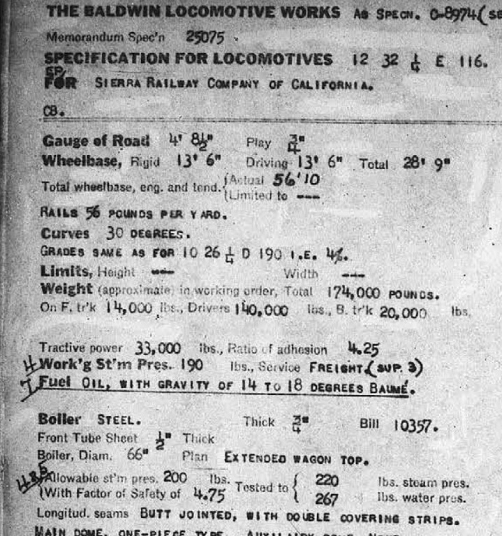

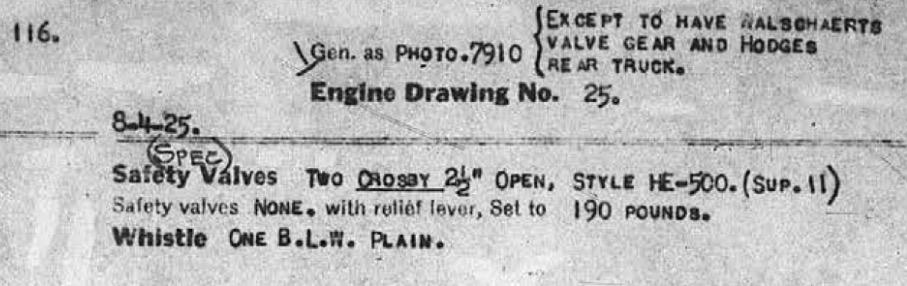

See here the Baldwin factory records for Sierra #34 -> working steam pressure and safety valves 190lbs.

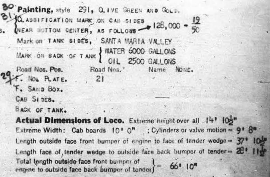

Posts: 268
@Tom

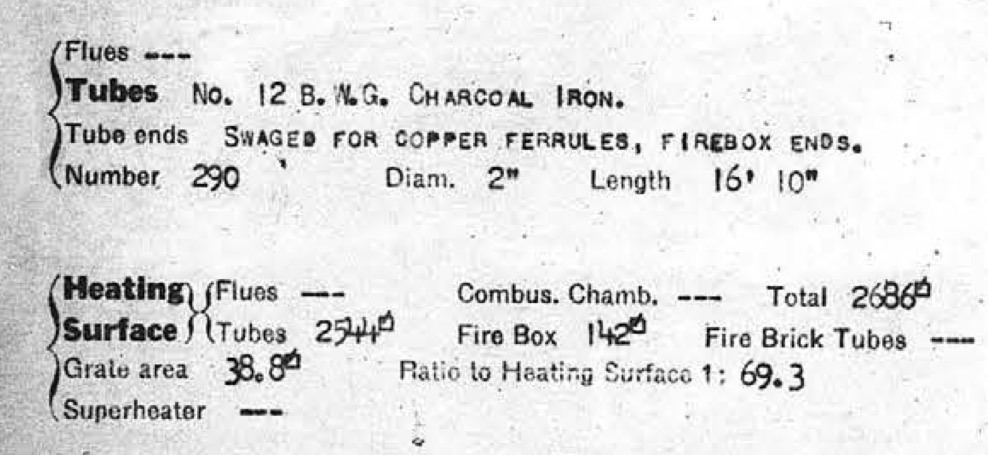

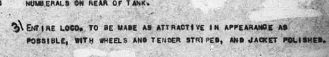

regarding the Santa Maria Valley #21.
Maybe Captain Hancock (SMV owner) was excentric I do not know.
But for sure he want his first (and only) new bought Steam Locomotive as nice and beautiful as possible.
Ordered with lagged smokebox. Polished jacket. Gold lettering.
"Attractive as possible"
And there was NO superheater when new.
The owners still have to decide to trade fuel economy vs maintenance. In this case to go for less maintenance.
There are several 1920s locos out with piston valves but no superheater
e.g. MRSR #5 this Porter also has no superheater.

OK, I asked a couple of old friends for help regarding the Sierra Ry. 34 issue. Both of these guys are retired rails and both had worked for the Sierra for a number of years.
34 always ran with 200 lbs. Also, because of that, her t.e. was 34,000 lbs. plus. I don't have the figure right in front of me.
This is where you can sometimes get into trouble even with company/ builder documents as they do not always reflect real world instances. 200 lbs., that's what she is.

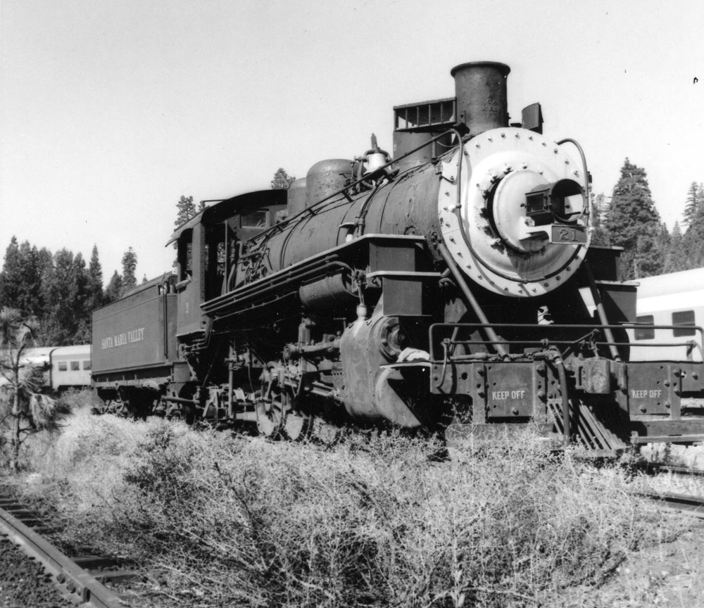

Here's a photo of the 21 in McCloud, part of a large collection of uncredited snapshots of McCloud excursions in the late 1960s and 1970s:
