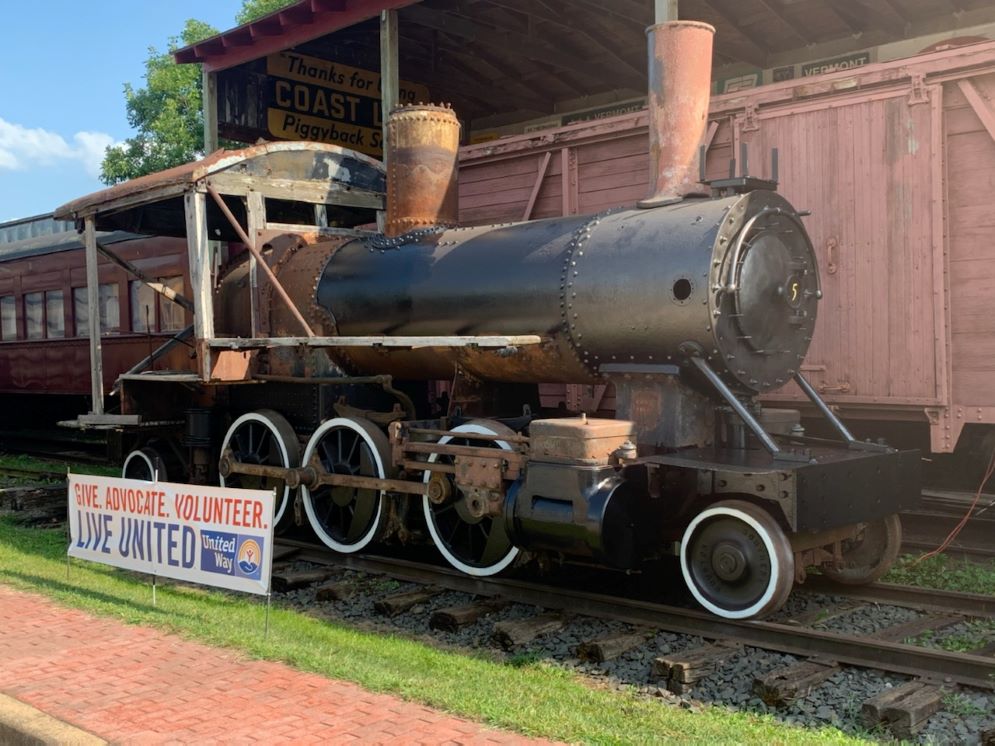

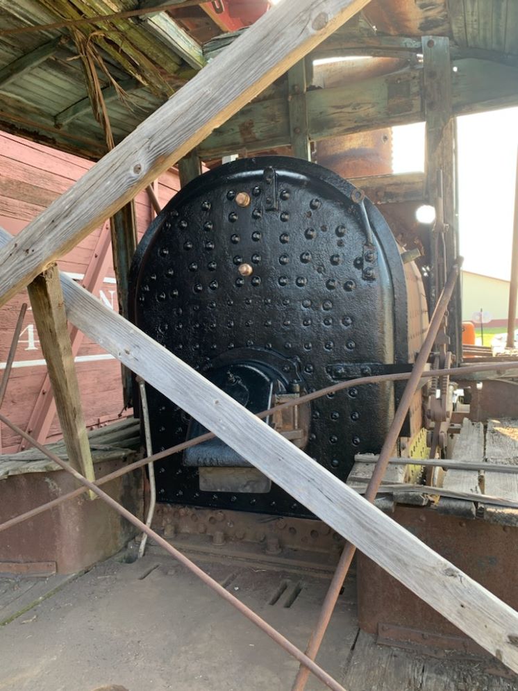

Here are the current shots of the Porter. The port I'm referring to is the hole about one foot back from the smokebox front

My guess is that the hole you asked about is for a cleanout plug. If you look under the smokebox, there is a large tube coming straight out the bottom, and venting below the pilot deck. During normal operation sand accumulates in the smokebox when the fireman sands his boiler tubes to remove soot. Most of it goes out the stack, but some piles up on the firebrick, and some settles in the smokebox. Whenever a routine boilerwash is done, somebody opens the smokebox front and cleans this out, but this job could have been done on your engine by pulling that plug out and sticking a hose in there, then washing the sand out the bottom.

You can weld up a replica for the casting that was probably used there, or if you want to get fancy 3DP a replica - I thing metal work for a one-off is much easier than programming, your mileage may vary. Or, weld in a plate, smooth it out and paint it if you can't make or find a replacement. Good hunting.

In the book "THE MAINE TWO-FOOTERS" by Linwood Moody, in a picture preceeding page 117, it shows an engineman standing on the steam chest of SR&RL Locomotive #24, on the fireman's side, with a long rod (probably a poker) extending into just such a hole on the side of the smokebox near the front. The caption says "...Only one engine, the 10, had a Hall-Slater self clearing front end. All the others had to be blown clean at the end of each trip. The cloud of steam to the 24's left is loaded with the cinders she'd gathered during her last, long mile up from Farmington that day."
Photos and drawings of #24 show cleanout holes on both sides of the smokebox.
Out of curiosity, I tried to find more about Hall-Slater self clearing front ends, but was unsuccessful.

Herb, I was going to mention that those cleanout hatches were a whole lot more common on coal burners than oil burners. We know that Audrey was delivered as an oil burner, but I'm thinking that before 1913 maybe Coronet used coal for locomotive fuel. So far I have found out very little about the Coronet Phosphate industrial railroad, if anybody knows anything, I would guess that the three people with Coronet locomotives to fix up would all be interested.

Does anyone have an example that we could use to have a new one cast? We have a foundry nearby that is willing to work with small projects like this if there is something available to make a pattern from.

Must be for the same diameter as your smokebox. This may limit your possible options.
