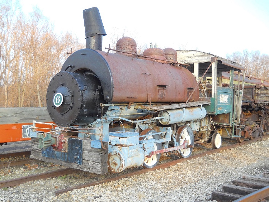

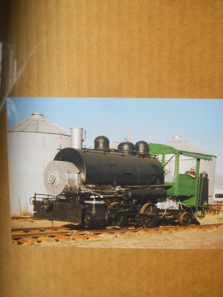

The first photo below shows "Audrey" (as she now is affectionately known) at the Hoosier Valley Railroad Museum in Indiana in 2012. Purchased by Sammy King and moved out west to Colorado, the second photo shows her recent appearance. Although my digital copy of Sammy's recent photo leaves a lot to be desired, I think the improvement in her appearance speaks volumes for what one person, with just a little bit of help, can accomplish!

Amen, brother Les and brother Sammy pursued this venture for some time until it came to fruition. Glad to hear that local help has come on board.
Sammy, I wish you continued good fortune with Audrey.

Wow! Just wow!
Such an improvement already! I'm sorry Colorado is just a bit far for me to come and help out on Audrey, Sammy, but I'm glad to hear there is at least one other young guy out there learning steam besides me!
I wish you continued luck and success with Audrey.

So what are the "innards like". Is the boiler sound? What do have to work with mechanically? I ask because I presume you plan on having a corn roast and will need a way to steam that corn. And blow the whistle? Agree Colorado is just a little far to come and offer some help. Then again maybe a weeks vacation out west might be what the Dr orders. Good luck to you and your project. By the way I enjoy your posts. Regards, John.

Gentlemen,
Thank you so very kindly for your comments and encouragement with restoring the "saddletanker of my dreams" !!!
John, She's really just "30 tons of trouble", a case of jacking up the whistle and building a new engine underneath, and providing the whistle myself... but we still love little Audrey:
The boiler looks to be original, some parts like the outer side sheets and bottom quarter of the front tube sheet, have extensive rust damage and will require replacement. A lot of other signs are much more encouraging, but right now it could go either way. When the weather got cold, I was digging the pieces of the two most inaccessible (as in, never ever removed) washout plugs out of their openings. I won't really have the answer until the brick and tubes come out, all the scale is removed, and I do a complete UT survey. Should happen next summer.
The running gear has about half a ton of welding rod in it, Audrey was wrecked, rolled, rear ended, rerailed, and repaired countless times in her life, and those repairs look to have been done between swing shift and day shift without dropping the fire. The springs don't have any spring to them anymore, and the spring rigging and brake rigging are completely eaten up and need the whole enchilada. She was not a store bought Porter back truck, the frame was extended in 1947 and a kit was obtained from Southern Iron & Equipment. The flame cut pieces look like they were chewed by a shark. The frame extensions are bent into a dog leg on one side, and busted clean in two on the other.
On the good side, the bearings seem OK, the tires have enough meat for another turn, with a bit of wear remaining first, and the wear on all wheels is even and concentric. When I bought the engine, the steam chests, valve gear, and reverser were froze solid, I thawed them out, and I am optimistic that the pistons won't be stuck too bad.
The saddletank and sand domes have many defects, but I can grind off dinkleberries good enough to patch those myself.
Woodwork is completely rotten, I have some of the cab left for a pattern. I replaced the floorboards on the engineer's and fireman's side, and patched the gangway, just so we could work. Big appliances are missing, but the little steam fittings are all still there.
The trick now is to live long enough to actually drive her before I croak, and it could go either way. Even if we end up doing a cosmetic restoration only, we are still doing whatever we can to make Audrey attractive as a future candidate for a running restoration, especially if the work just requires slave labor.
One thing about this restoration is unique in my rail preservation experience, --- for the first time in my life, NOBODY is working against me or trying to screw up my project somehow. I think this is better than having money... and I think that Audrey still has a bit of fight left in her.

Thanks for the update on what your finding. Sounds like just about every other steam locomotive out there with the exception of late Nickle Plate Berks. Everything you mention sounds familiar. If it wasn't one part being sour it would be another part that was. You start digging and what repairs you find one would think someone made this up. Then there is what the mfg forgot to do or got away with. A while back one of the knowledgeable folks made the comment that "owning a steam locomotive is a way of life". You really must want to "hate" yourself. Sincere best wishes on this endeavor and would be happy to donate time if it ever worked out. Cheers, John.

"Audrey" before Mr. King started cleaning her up. Photo from my visit to North Judson, for the 765 trips in 2011. Always wondered if anyone had saved her or what her fate was. Glad she's in good hands.

Also, I should again credit Les Beckman for actually starting to clean up Miss Audrey. If you look at the picture from 2011, you can see that he painted the smokebox and front of the saddletank, as well as a tasteful treatment of her number plate. If his picture of her hadn't floated to the surface on RyPN one day when I was bored (Feb 3, 2015, to be exact), she could have ended up in that big roundhouse in the sky, with me never knowing the difference. VIVA LA DIFFERENCE.
