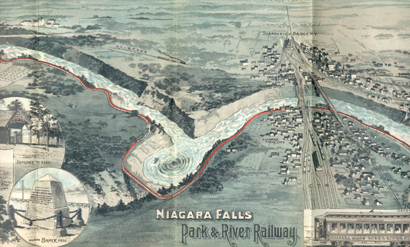

I have several original folders showing the park railways. On the Ontario side was the Niagara Falls Park & River Ry. It ran from Chippewa. above the falls to Queenston. It is shown as a double tracked line.
That line connected with the electric line on the U.S. side via the arch bridge just below the Falls and via the northern suspension bridge connecting Queenston and Lewiston. The U.S. side is also shown as double tracked. This combination was referred to in another folder as The Niagara Belt Line.
Not sure if the image will show -- I had to reduce it to post here. It is the centre section of the fold out map. One can see the former Great Western Ry. Suspension Bridge and the Michigan Central R.R. bridge to the south.
I remember in the CNR 6060 regularly scheduled service to Niagara Falls, we would roll out on the Suspension Bridge and pause for a while so passengers could see the river. Then we would carry on to Toronto. I don't recall seeing that old boiler.
