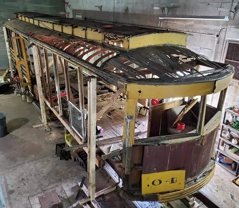

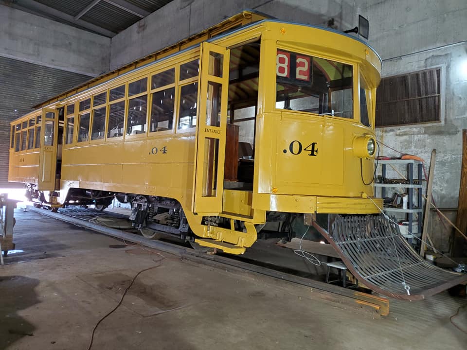

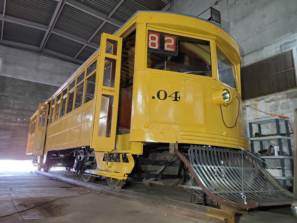

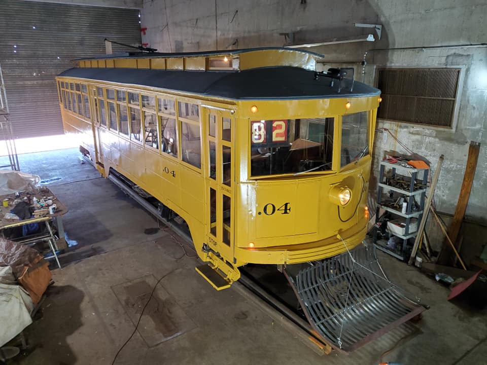

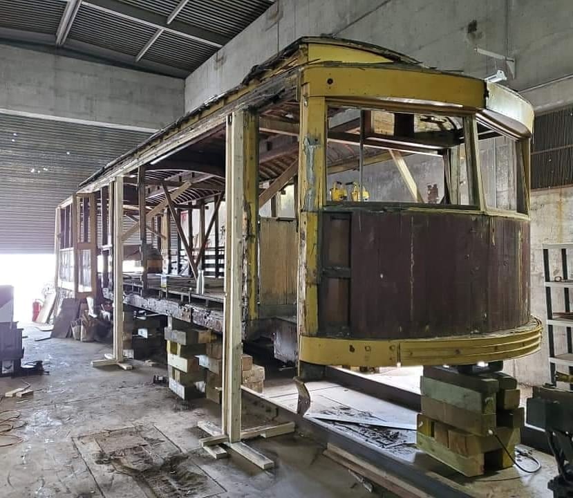

After 22 months Denver 04 built by Woeber in 1911 is finished and ready to head to Arvada from the silo in Cheyenne. 04 was the last Denver trolley in public operation on the night of July 2nd 1950, the system closing after its last run. Its been a long road for 04 having been a mountain cabin and then a exhibit at the Forney museum then purchased, before being demolished by Wally Weart, it then spent many years in a storage yard before coming onto the list of Colorado's 10 most endangered places and receiving grant funding for a static restoration. It will go into a park on Grandview next to Wadsworth with a pergoda style roof over it. All original Denver interior seats were found in storage in a barn in Colorado, you just never know whats out there !

That is one great restoration, which almost seemed to be, just one set ahead of being torched.
Where did you find the trucks?
Are they original to that type of car?

Alco420
Michael had a question about the trucks come up on his Facebook page where he has been documenting the progress on .04
"its on caboose trucks, trolley trucks a are incredibly rare."

Its sitting on CBQ caboose trucks which is what it has had since the Forney days, we however modified the trucks to lower the body and make it look less obviously high.

Denver trolley gauge was 3' 6". That makes it 6" wider than one of the railroad gauges used in Denver!
And 3' 6" gauge trolley trucks are even more extremely rare. What did it have when it ran in regular service?
Refence the Denver Tramways book, the .04 had a pair of Brill 27G trucks (4-foot wheelbase) and with such a short wheelbase, it appears the motors were outside hung.
