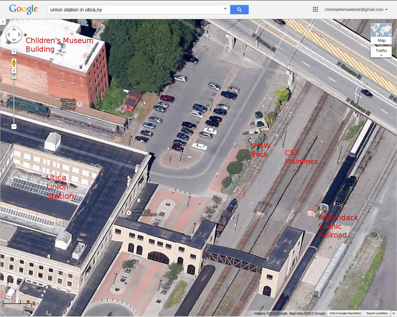

Here is a Google Map "birds-eye" showing the U&MV Chapter's equipment, Utica Children's Museum, Utica Union Station and the Adirondack Scenic:

Posts: 1099
Here is a screenshot of the google map aerial view, to which I have added a few labels, in red text.
The U&MV Chapter equipment consist of the green RSC3 diesel, stainless steel diner next to it and the red PRR caboose.
The equipment doesn't have to move very far to reach live track, but there isn't a lot of room for cranes to work in.

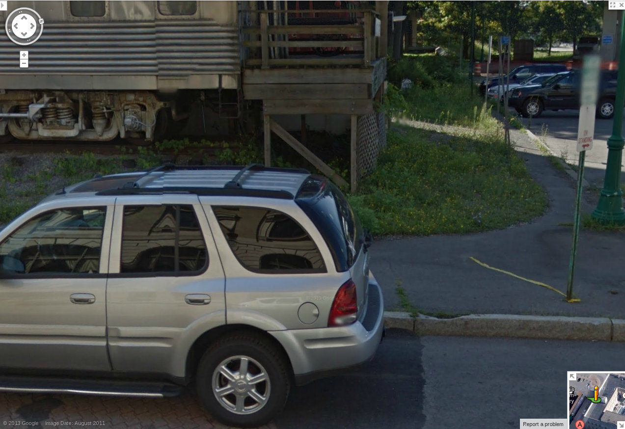

Dave wrote:
Lightweight temporary track across the parking lots, one lift and swing onto the NYSW track. You can lay the temp track yourself.
The display track is 3 to 4 ft higher than the street and parking lot. Here is the link to the google street view; below is a screenshot.

 Post subject: Re: Update on Utica & Mohawk Valley NRHS Equipment (9/6/2013
PostPosted: Tue Nov 19, 2013 10:35 am
Posts: 728
What a difficult spot to get this stuff out of. Wedged in tight against buildings, with that roof overhang nearly touching the equipment, and hardly any room for trucks and cranes. Just try to sling the equipment without interfering with the building. There is absolutely no room on the building side for jacking, setting up a house moving rig, or most of the other alternatives to cranes. No wonder the quotes are so high.
The drop-off on the coach end would normally be helpful, but there are so many curbs and things you couldn't get a trailer in.
It looks like the best method would be to lay temporary track as far across Main Street and the far sidewalk so the equipment could be pulled forward for crane access. Even so, there's a low fence just past the sidewalk that probably can't reasonably be moved.
At least in that location, there is adequate room for cranes and floats, or house moving equipment.
City permits, street closures, night and weekend work... no way around it, this will be expensive. The panel track and any timber shims should be prefabricated and stacked neatly nearby to save time during the actual move.
Hopefully the museum will come to its senses and stop making a difficult task even harder... and it should be clearly pointed out that THEY made removal of the equipment so difficult by building ramps, decking, and a roof right up to the edge of the locomotive and coach. The "rental" threat is ludicrous... it should be pretty much cancelled out by the rental bill for using the equipment all these years.

4 feet is nothing....tie crib on a slope to drop it down to the level of the NYSW grade. The challenge there is to prevent runaways.....heavy dozer with a winch would do the trick.
Where did I put my torch striker...
The elevation of the display track is a blessing... it will allow the temporary track to be built on tie cribs and pass right over side walks, curbs, fancy paving, etc. leaving them un-molested. Consider the damage if the display track was below grade and a trench had to be excavated through all that pavement.

Posts: 728
However, moving toward the railroad will require dismantling the portion of the deck which wraps around the coach's end, and the museum isn't exactly cooperating.
What seems perfectly sensible may not be an option.
Coming out toward Main Street is still above the height of the curbs, sidewalks, etc. but doesn't require nearly as much cribbing, and doesn't require "damaging" an already- hostile landlord's property.
