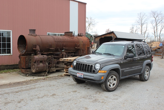

Some of you may be familiar with the extremely heavy 23" gauge 0-4-0Ts that Porter built for the Jones & Laughlin Steel Co. to move ingot trains at their Pittsburgh Works. Several of them went to Crown Metal Products in Wyano, PA and two eventually made their way up to Benkart's Rigging in Cranberry, PA. In 1998 I stumbled across the locomotives, No. 58 and 59, and made a tentative deal with Mr. Benkart to purchase the 58 for $5,000.
However, I was saddled with the reality that I owned no land and really had nowhere to move it to, so that deal fell through. Benkart sorely needed the space that the locomotives occupied, and after my friend and I noticed that one of the cylinders on 59 had frozen and broke, Benkart decided to scrap the 59. Through a post here on RYPN we found a taker for the boiler, the Niles Canyon RR in California, and it went west, the frame was cut up and the drivers, rods and misc. other parts were set aside.
That ended my involvement with the two locomotives. I did not know what had become of the 58, but a few years later discovered that it had been moved to the J.S. Company in Middlefield, OH, and that Pete Jedlicka, a good friend of mine, had purchased it from Jonas. Recently while in search of a steam locomotive project for us to work on at Youngstown Steel Heritage I made a deal with Pete to purchase the 58 and to move it to Youngstown for a full restoration to its original appearance, including a return to operation.
Since the 58 is a steel mill locomotive it fits into our mission at Youngstown Steel Heritage. Although not specifically of Youngstown significance, it is similar to countless small Porters built for steel mill service. The 58 is not your typical two footer. In working order it weighed 93,000 lbs., has frames of SOLID steel plate, solid steel drivers and even the bottom plates of the saddle tank was 4" thick. It was built to pack as much tractive effort as possible into a package 20' long, 6' wide and 8' tall. The locomotive also does not have many of the standard appliances found on other locomotives such as brakes, headlights, bell or even coal storage capacity. It was built strictly for moving extremely heavy ingot buggies within a tightly confined area, and apparently was fueled in between switching moves from trackside piles of coal located in strategic areas.
I am making arrangements for moving the 58 to Youngstown, and over the past couple of weeks I have been laying 23" gauge track for it to roll on. I am using 100 lb. RB section rail laid mostly on steel ties bolted with no. 62 crane rail clips. This includes a 40' radius curve, about as sharp as I dare take the loco over. The track will extend about 300' to the end of our property and will have at least two sidings that run back toward our main building.
The ultimate goal is to construct a small fleet of ingot mold buggies, have some new ingot molds and ingots made, and get to the point where we can demonstrate the entire ingot teeming and stripping process. For those who are not familiar, the old way of making steel involved pouring molten steel out of a bottom pour teeming ladle into cast iron ingot molds. The steel solidified into ingots which were then rolled in a blooming mill and finishing mills to finished shapes. Today continuous casting has eliminated ingots from all but small specialty steel mills. The ingot molds are carried on small extremely heavy flatcars known as ingot buggies. The ingots are teemed while the molds are on the buggies, and then they are moved out into a yard to solidify. After a certain period of time these trains are moved to the stripper where a specially outfitted overhead crane pulls the molds off of the ingots and then placed the molds on a train of empty buggies on an adjacent track. The train of stripped ingots then move to the soaking pits and the train of empty molds goes back to the Open Hearth to be teemed again.
Now that we have the locomotive, we will work on its restoration while simultaneously designing the new ingot buggies and molds. When completed, the new "ingot mold railway" will fill a gap in rail preservation by focusing on the specialized industrial side of railroading that most other museums overlook.
File comment: J&L 58 as she appears now. Imagine that, 45 tons of steam locomotive in a package as small as a Jeep Liberty.

That there is easily one of the ugliest pieces of machinery I've seen... I like it! Obviously 58 is something of a long term project, but if eveything is there, then why not give it a go?

Check out that photo of the crown sheet. Yikes, that's what I call UGLY. Looks like boiler washes were not a regular occurrence in the lokie's later days.
A worthy preservation project, Mr. Rowlands.
