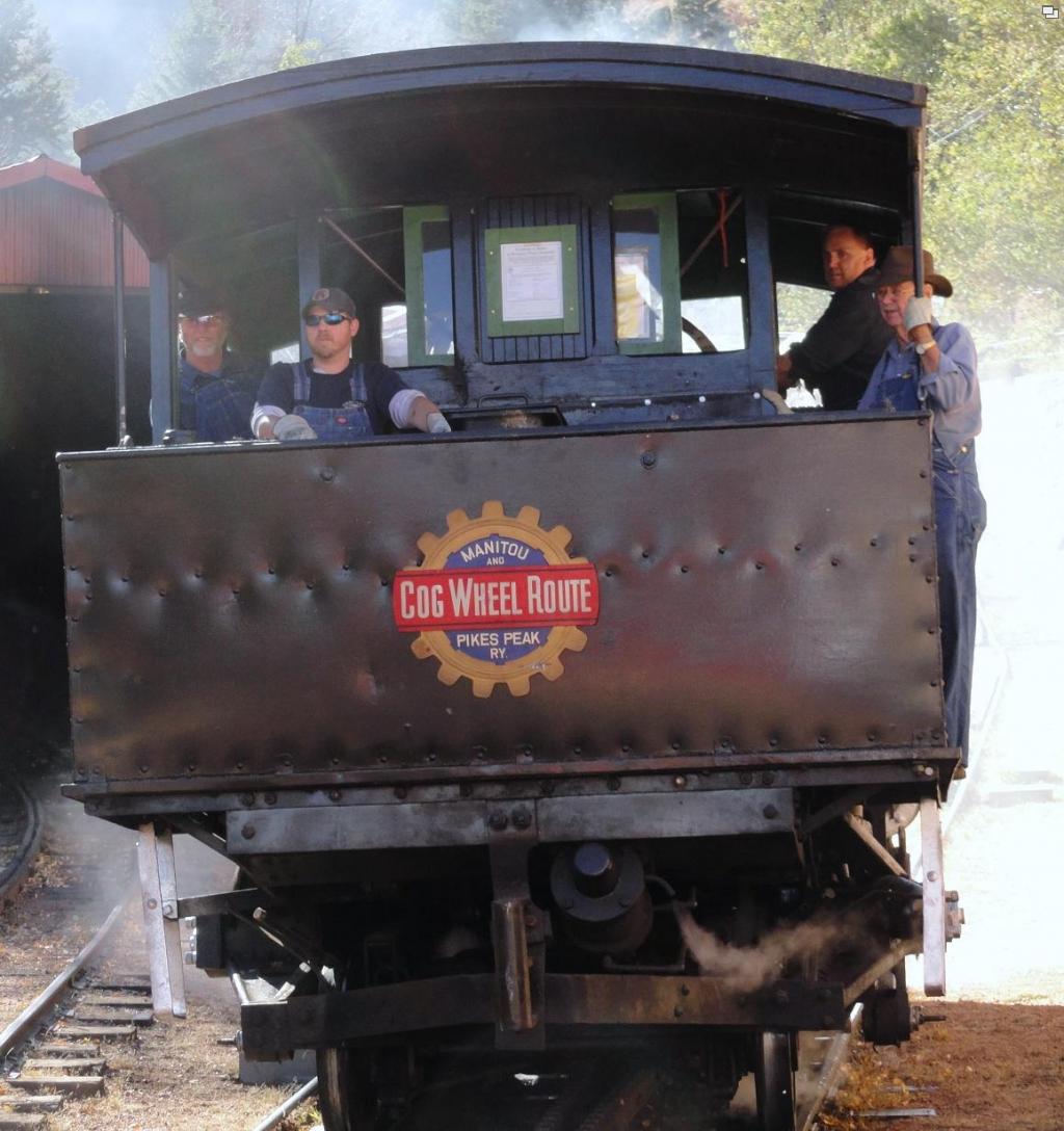

I was fortunate enough to get some (very little) firing time on No. 4 several years ago. No. 4 was converted from coal to oil in the 1980-90's and ran very seldom after conversion. The firebox is short and wide, making it a little difficult to get the burner appropriately positioned and adjusted. Since the locomotive wasn't used that much, a lot of the "bugs" regarding the conversion (air, dampers, etc.) were not resolved. These locomotives, while in regular service, never had any water glasses, using various gauge cocks as described, on both the fireman's and enginer's side. When I fired it, I do not believe the single water glass was properly installed as it was difficult to make any determination regarding water level. Needless to say, the engineer and I were constantly checking the gauge cocks and I always had more water than necessary most of the time...creating other problems. In addition, Baldwin equipped these locomotives with screw throttles and reversers. During the early restoration, the screw throttle was replaced with a traditional "lever" throttle, making it very difficult to make fine throttle adjustments, creating additional problems for the fireman trying to make adjustments with the fire.
These locomotives were also not equipped with any air brakes, but only 2 steam "jam" brakes, one for the fireman and one for the engineer. A water brake, along with the reverser,, was the primary braking when coming down the mountain, making for an exciting trip from what I understand. The hand brake was also effective. :)
