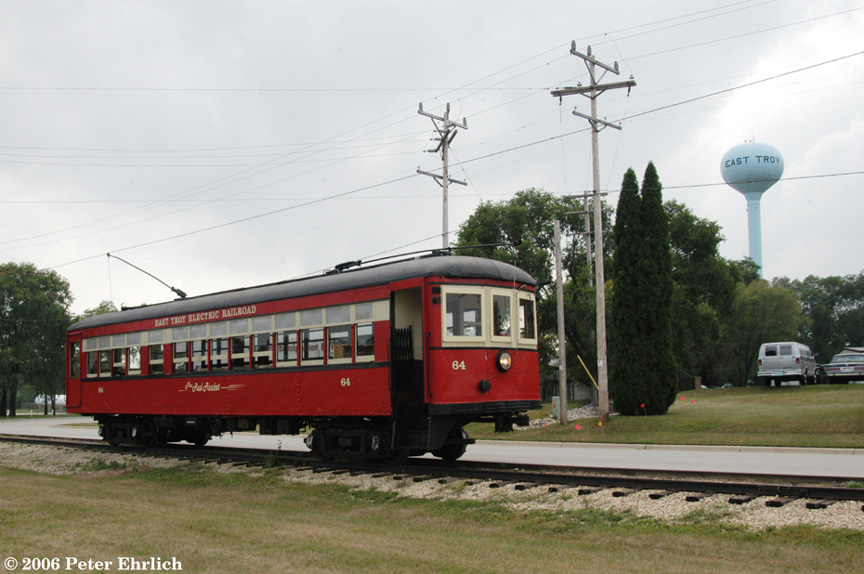

I directed the painting of a former Philadelphia and Western transit car. It was a brush and roller job, using quality equipment and tractor enamel. Worked out just fine and still looks good 20 years later.
