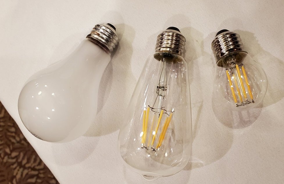

Brought this thread back with an update on 32 volt bulbs.
I found two "Edison Filament" LED bulbs on Amazon last winter and tried them out this summer. They work great. Do not know how long before they change or go out of stock as Chinese things seem to do on Amazon.
https://www.amazon.com/Voltage-Incandes ... 8VL/ref=sr
https://www.amazon.com/SHUWDKAR-Voltage ... 7N4/ref=sr
As mentioned in my last post the Damar Chinese incandescent 34V bulbs are expensive to keep replacing for display use. The photo shows a comparison with a 50W Damar bulb.
Both LEDs work on a wide range of voltages. I tested them in the shop from 9 volts to 36 volts DC. And 12 to 24 AC. A tiny internal ballast in the base keeps the wattage and brightness the same over that range.
We did need to put a vented 10 Watt dummy load resistor above the power panel. That keeps the almost unloaded shore power transformer voltage below 34 volts. Again that's RMS average, if you looked on an oscilloscope the peak rectified DC voltage can run to 48 volts. So I think they would be happy on a locomotive generator. We ran them on a couple trips in the dynamometer and they also held up under some vibration.
I have sprayed frost paint on some. Once frosted brightness is closer to a 25 W and 50 W incandescent bulbs.
https://www.krylon.com/products/frosted-glass-finish/
If careful, applying the frost paint they look almost identical to the incandescent bulbs. At such a low operating temperature it should last but I'm going to check on that later.
