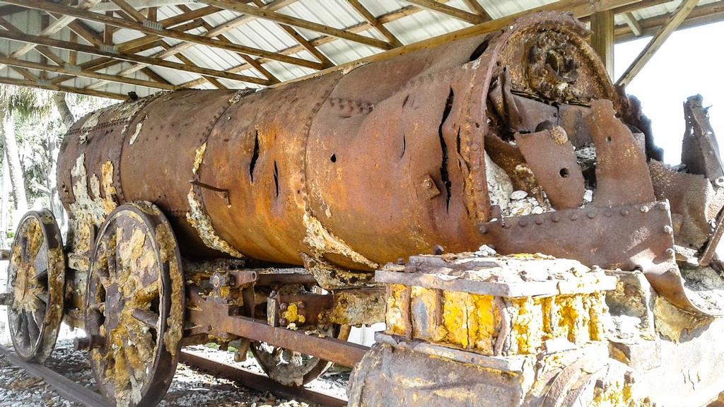

Bartman-TN wrote:
If you do a search, some photos of a steam locomotive found buried near Mulberry, Florida, can be found. It was discovered in 2012. Basically the remains packed in dirt. It is now on display at the Mulberry Phosphate Museum. The museum is worth a visit if you are in the area.
https://www.steamlocomotive.info/vlocom ... play=27479
https://www.youtube.com/watch?v=4QyuW4FYtv8
Phosphates are obviously about the worst medium for a steamer to be sunk in, I doubt the AT&SF engines in KS would be so rough (photo: Robert V.).
