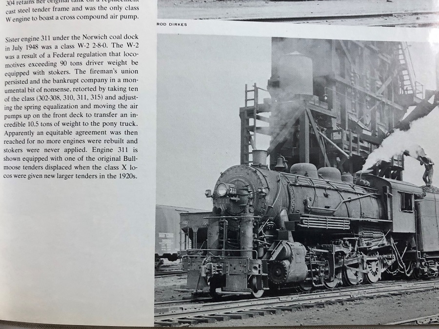

On a related note, I found this interesting caption in a book about the NYO&W regarding weight on drivers vs. requirements to equip with a stoker:
This is from the book "The Final Years - New York, Ontario & Western Railway" by Carstens Publications. Admittedly this is a "railfan" book, and not original archival material, so without doing some digging I don't know just how accurate the weight vs. stoker comment is, but interesting to ponder nonetheless.

In correspondence in the early 1950s the Alaska Railroad responded to a request from the union to add stokers to the S-160s. The weight didn't meet the threshold and the request was denied.
