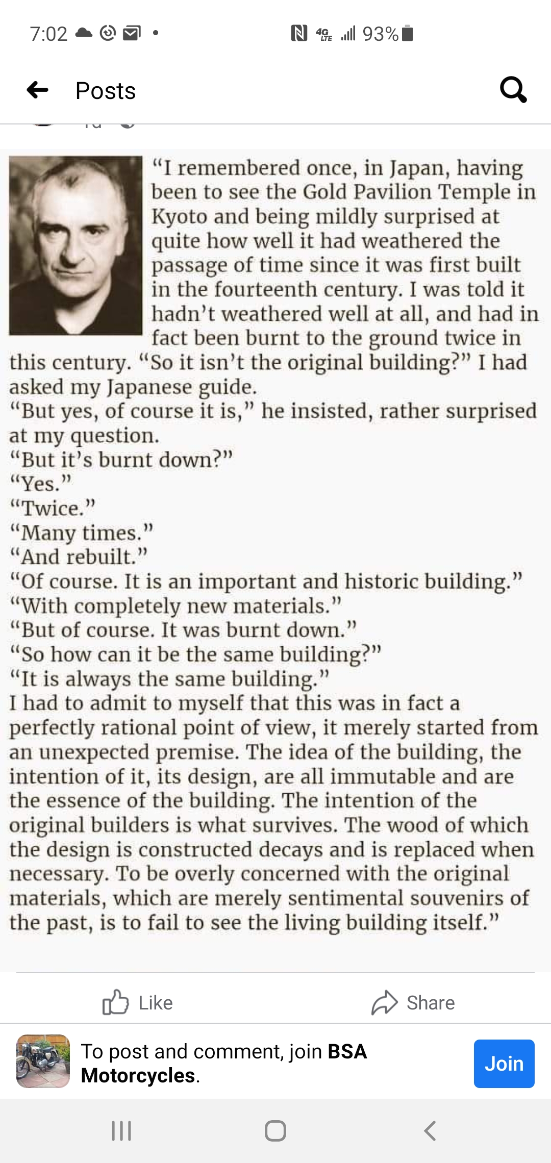

Thoughts?

In Japan, most shrines are rebuilt every 20 years. The ones I visited in Kyoto still seemed like authentic 1000 year old structures to me.
A close family friend works full time at the Kyoto National Museum. She was an art major specializing in sculpture, and her job is to go out to nearby temples and shrines to do wood restoration work on both buildings and statues. Her family owns a temple that is over 700 years old, so she grew up with that understanding of history around her.

Unless the artifact is preserved in situ, there are bound to be deviations from the original piece. "Old Ironsides" the USS Constitution floats preserved in salt water. Nearly everything on the wooden battleship has been replaced except a few metal non-functioning parts. Yet it is considered original. An example I liked to give when teaching US History to middle schoolers was George Washington's original hatchet. Even though it has had 2 new heads and 3 new handles it's still considered his original hatchet. A real head-scratcher.

Are you going to use it, or are you putting it in a glass case in the Smithsonian. If it's to be put on display for future historians to examine and learn from, great, keep as much of the original as possible. If it's going to be used, well, then maybe 150 year old boiler tubes aren't the right choice.
Also, a lot of it has to do with how the artifact is repaired. Using the well worn hatchet example. Were the replacement handles and head the same type and style of material as the original? If it's still a hand forged head and a hickory handle for example, then you could consider it to be the same artifact. If the handle was upgraded to carbon fiber and then the head was replaced with stainless steel, even if it's the same shape, then not so much.
I also suspect who did the repair and when they were done matters. If Washington replaced the head and handle, that's one thing, it's still his axe. If 14 later owners have all swapped them 2 or 3 times, then you've likely lost the original someplace along the way.
Again, it's a matter of the final goal. Some railroad use as much original material and designs as they can. Others embrace modern technology and do things like using completely different structural components. Which one is right? That depends, what's your goal?

I think the line between preserving the historic fabric; versus rebuilding with improved design and materials in the interest of improving the efficient use or operation of an old artifact is clear.
I don’t believe that preserving the historical fabric means that missing pieces cannot be recreated and applied with the same design and materials that were known to be used on the original artifact. Even in cases where the exact design or materials of a missing piece is unknown, I think that preserving the historic fabric permits honest assumptions to be made in choosing the replacement of such missing pieces.
The Washington’s hatchet analogy seems to imply that preserving the historical fabric is not a feasible goal. But this belief would have to include the assumption that replacing any lost material disqualifies the attempt to preserve the original fabric.

The question of retention of historic fabric comes up repeatedly. Retention of historic fabric is dependent on the artifact's best state in terms of interpretive value as determined by the owner of the artifact. When considering retention of original fabric some pertinent inquiries may include:
1. To what historic era is the original fabric in question original?
2. How does the removal /replacement of said original fabric impact the interpretive experience?
3. Does retention of the original fabric put the artifact at risk?
In JR's example, a frame up on an MG will eliminate the many odors associated with these old cars. My Uncle's '53 MG TD also smelled like mold, gas, and oil (exposure to which may negatively impact the health of anyone experiencing the car) when he bought it. While our restoration may have removed these sensory elements, the driving experience in terms of road feel, steering effort, and just the plain old feeling of taking one's life into one's hands every time we took it out to do 60 mph ++ on Ocean Parkway were not impacted. More importantly, removing the source of those odors (especially the mold) was important in the stabilization of the car. Unfortunately, the removal of the gas smell was ephemeral as the gas tank gasket remained problematic as long as my Uncle owned the car.
The more lasting challenge with removal/replacement of original fabric is in documenting any changes because the most important aspect of original fabric is often unseen in that the original fabric often contains knowledge of means and methods that are lost with the original fabric. Documenting changes is easy but how does one insure that the record of the changes to an artifact and the interpretive significance of those changes is retained with the artifact?

https://en.wikipedia.org/wiki/Ship_of_Theseus
"The ship wherein Theseus and the youth of Athens returned from Crete had thirty oars, and was preserved by the Athenians down even to the time of Demetrius Phalereus, for they took away the old planks as they decayed, putting in new and stronger timber in their places, insomuch that this ship became a standing example among the philosophers, for the logical question of things that grow; one side holding that the ship remained the same, and the other contending that it was not the same."
