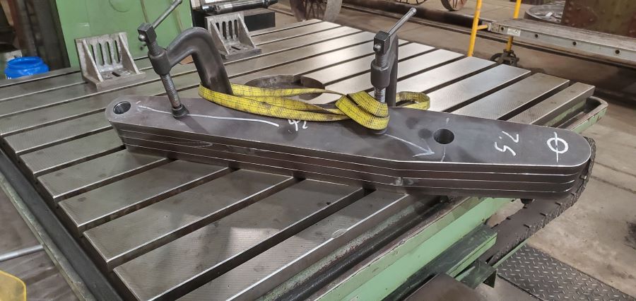

Work has begun and much work has been performed over the past couple months on three brand new thermic syphons for ex-Boston & Maine #3713 undergoing restoration at Steamtown National Historic Site. The initial bends have been made on our McCabe flanging machine, and the main halves of the syphons have been welded together. We are now working on tooling to form the upper flanges and lower throat portions of the syphons.

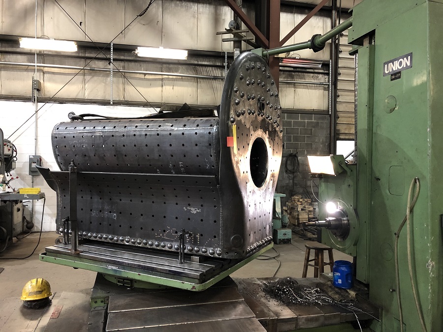

Work has continued on a new locomotive boiler, with much work being done to assemble the firebox. Inner and outer firebox sheets were assembled with the mudring, and sheets welded to each other. The sheets were then seal welded to the mudring, and mudring rivets were installed. Backhead brace T-irons have been fitted and riveted to the upper portion of the backhead. The entire firebox assembly then made a trip to our horizontal boring mill to have washout plug holes, and water glass and fitting holes drilled and tapped.

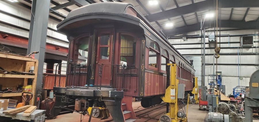

The final deadline and window for work was tight leading up to our Lounge Car #118 being placed into service in November 2018. The most necessary and immediate issues were addressed at that time, however it was understood that there were some components that were in less-than-optimum condition and would likely need to be addressed in the future. We were able to allot some time this winter to perform some further overhaul work on the “A end” truck. Work primarily focused on the interface between the journal boxes and pedestals, journal boxes and equalizers, and eliminating some wear in the foundation brake rigging. This work will allow this truck to perform reliably well into the future, likely requiring only routine servicing.

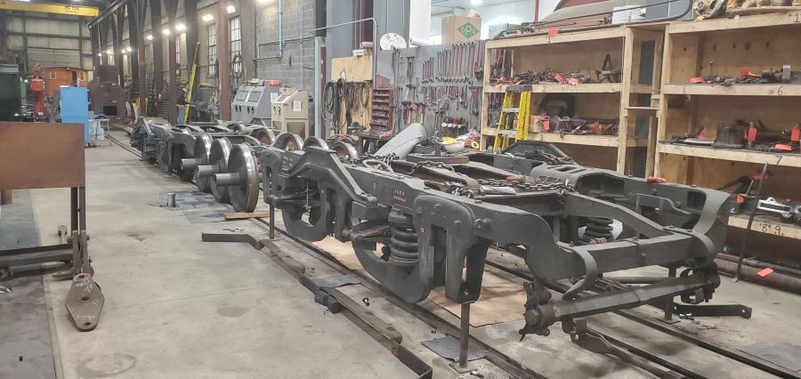

Our Parlor Car #88, the Marian, made her way into our shop for some mechanical work as well. Work here focused on repairing wear in the foundation brake rigging. The brake heads on the ends of her brake beams had come loose and were working their way out of gauge and off the tread of the wheels. A set of four brake beams was salvaged and repaired from one of our other cars to replace the original beams in-kind. A few new brake levers were made, worn holes were repaired in other components, new brake beam hangers were made, and new pins were made to provide a factory-fresh fit with their mating holes.

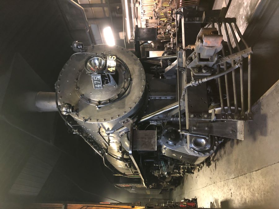

Erich -
Thanks for the wonderful report on the projects going on at the Strasburg Rail Road Shops. Especially appreciated the photo of N&W Twelve-Wheeler # 475 with its centered headlight; certainly one of the best looking locomotives running these days.
