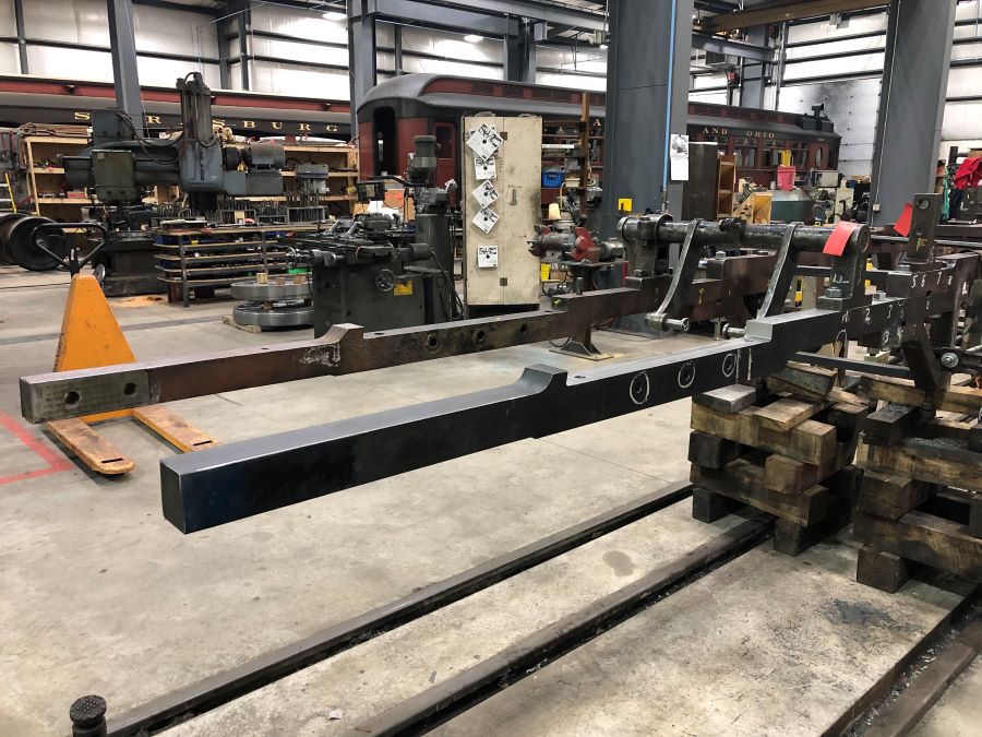

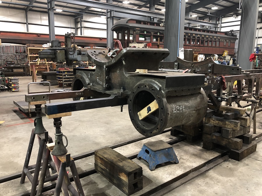

Heavy overhaul work has continued on a locomotive in our shop, with a new left front frame rail being machined and installed to mate properly with the existing frame components. Upon inspection, the original frame rail was found to have many defects and indications from previous service.
The new frame rail encompassed the area that supports and secures the main cylinder block. As such, the cylinders were reattached after ensuring the cylinder bores were centered laterally, and positioned parallel and level with the frame.

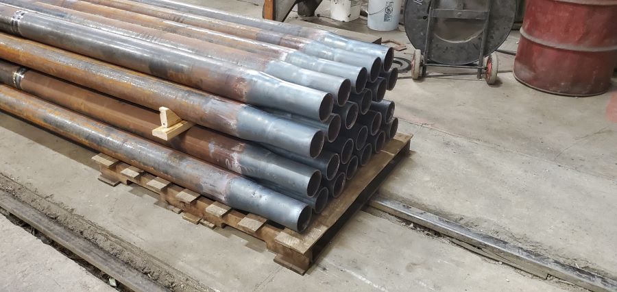

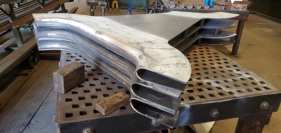

Work has begun and much work has been performed over the past couple months on three brand new thermic syphons for ex-Boston & Maine #3713 undergoing restoration at Steamtown National Historic Site. The initial bends have been made on our McCabe flanging machine, and the main halves of the syphons have been welded together. We are now working on tooling to form the upper flanges and lower throat portions of the syphons.

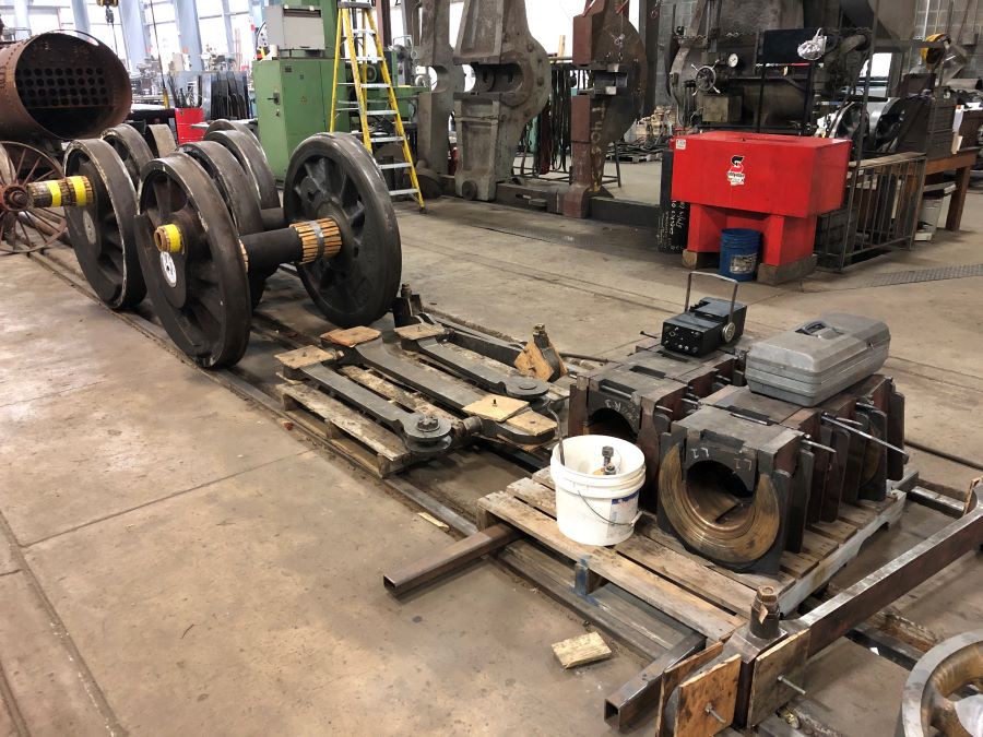

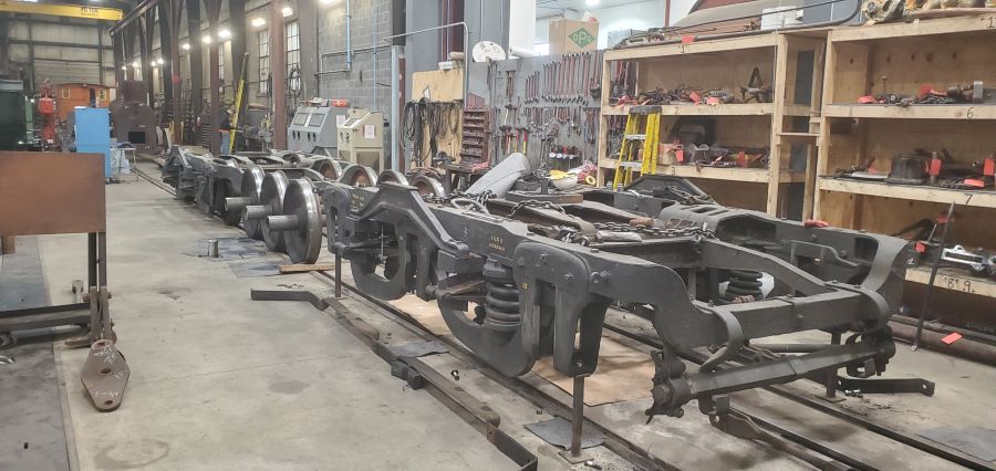

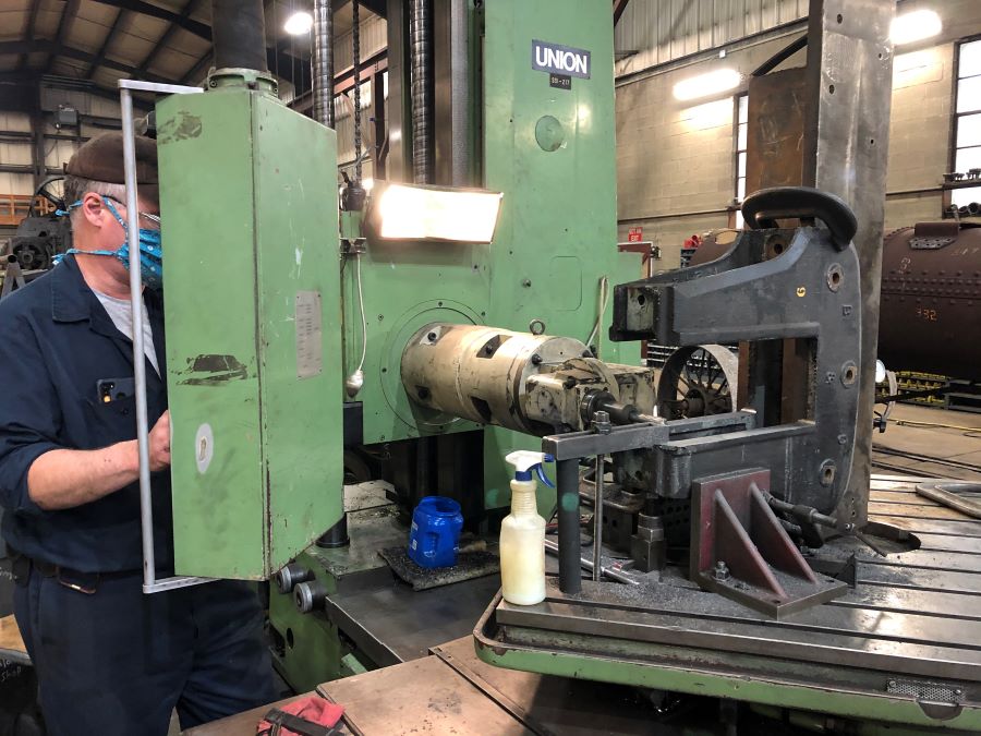

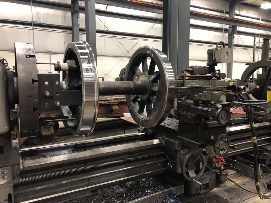

We performed overhaul work on the driving wheelsets of a 2-8-2 locomotive. This work included turning the tires, turning the main crankpins to proper quarter and throw, boring the crankpin holes in the secondary drivers to meet the dimensions on the main wheelset, and making all brand new secondary crankpins. This locomotive is a regular and reliable performer for our customer, and as such was in service until the very end of their 2020 season, and will return to service shortly in 2021. This, then, necessitated a quick turnaround for this overhaul work which our team was able to meet, completing the job within 60 days.

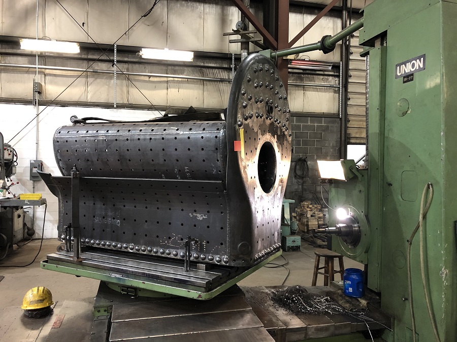

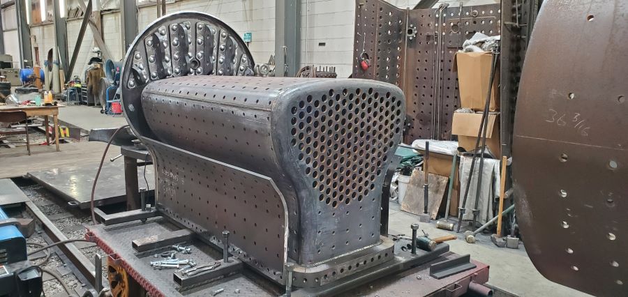

Work has continued on a new locomotive boiler, with much work being done to assemble the firebox. Inner and outer firebox sheets were assembled with the mudring, and sheets welded to each other. The sheets were then seal welded to the mudring, and mudring rivets were installed. Backhead brace T-irons have been fitted and riveted to the upper portion of the backhead. The entire firebox assembly then made a trip to our horizontal boring mill to have washout plug holes, and water glass and fitting holes drilled and tapped.

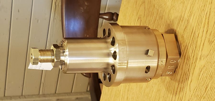

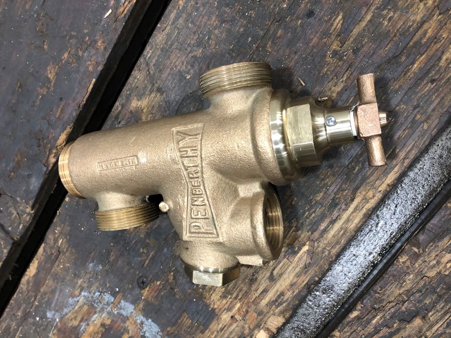

A customer of ours found themselves in search of better performance and reliability in the operation of the low-pressure safety valve on their locomotive. (Up to now they had relied on a make and model primarily meant for one-time use stationary service.) To that end we manufactured a brand new 1.5” Consolidated type valve. There are now well over 100 of our reproduction Consolidated valves in service on locomotives across the country.

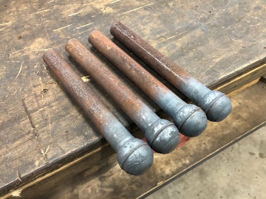

We have been filling various orders for staybolt material, forged head flexible staybolts, and flexible staybolt accessories.

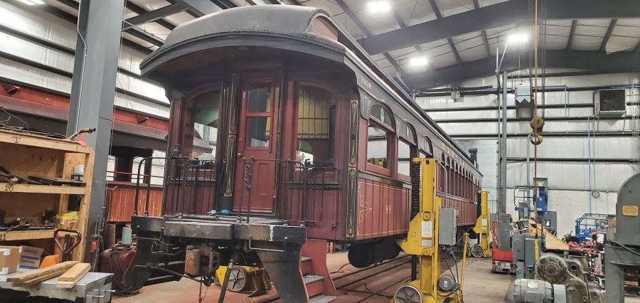

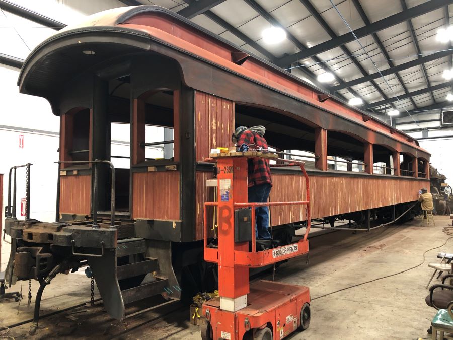

The final deadline and window for work was tight leading up to our Lounge Car #118 being placed into service in November 2018. The most necessary and immediate issues were addressed at that time, however it was understood that there were some components that were in less-than-optimum condition and would likely need to be addressed in the future. We were able to allot some time this winter to perform some further overhaul work on the “A end” truck. Work primarily focused on the interface between the journal boxes and pedestals, journal boxes and equalizers, and eliminating some wear in the foundation brake rigging. This work will allow this truck to perform reliably well into the future, likely requiring only routine servicing.

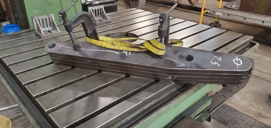

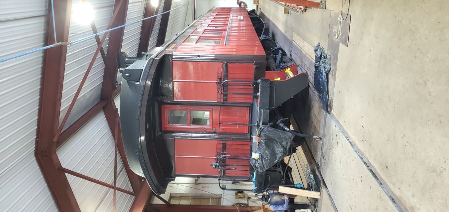

Our Parlor Car #88, the Marian, made her way into our shop for some mechanical work as well. Work here focused on repairing wear in the foundation brake rigging. The brake heads on the ends of her brake beams had come loose and were working their way out of gauge and off the tread of the wheels. A set of four brake beams was salvaged and repaired from one of our other cars to replace the original beams in-kind. A few new brake levers were made, worn holes were repaired in other components, new brake beam hangers were made, and new pins were made to provide a factory-fresh fit with their mating holes.

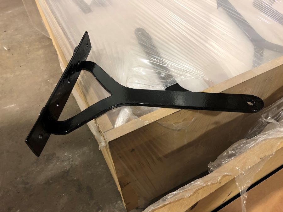

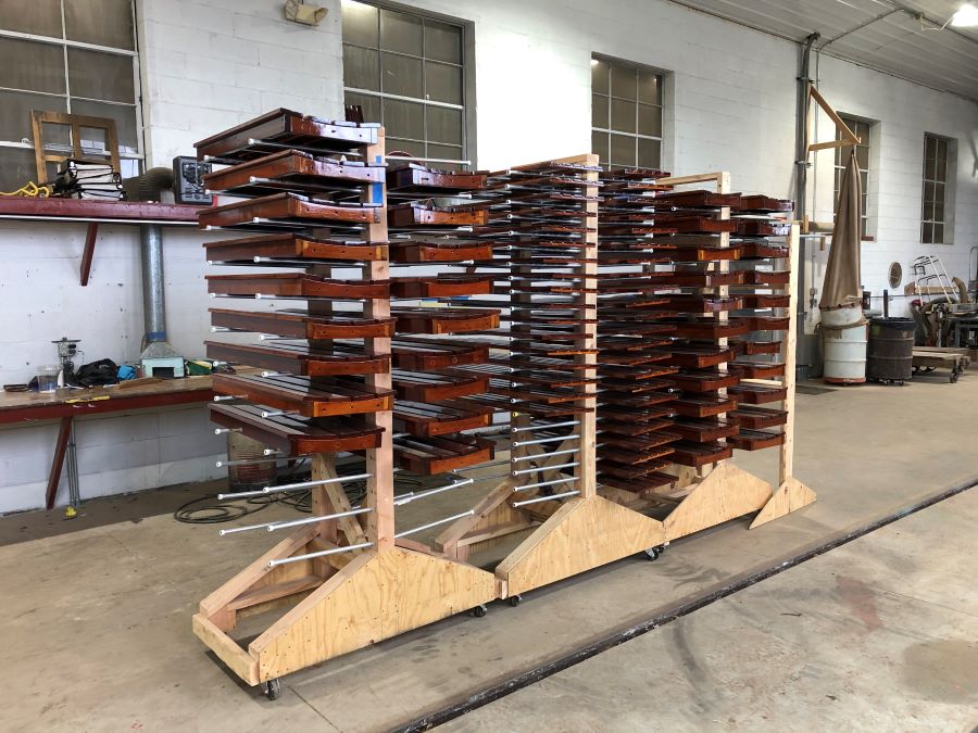

Seat hardware was given a new powder coat of gloss black.

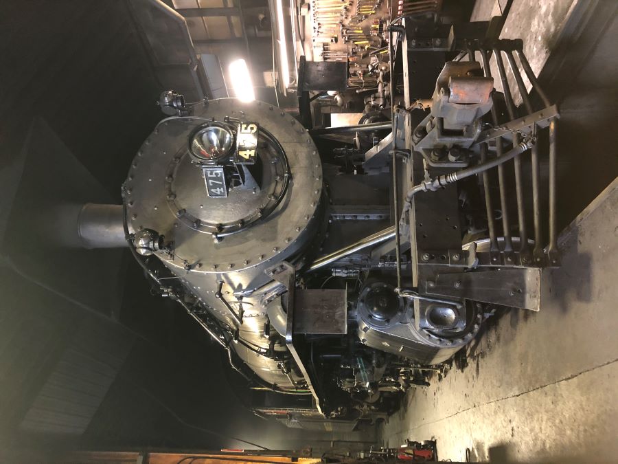

Thanks for the wonderful report on the projects going on at the Strasburg Rail Road Shops. Especially appreciated the photo of N&W Twelve-Wheeler # 475 with its centered headlight; certainly one of the best looking locomotives running these days.
