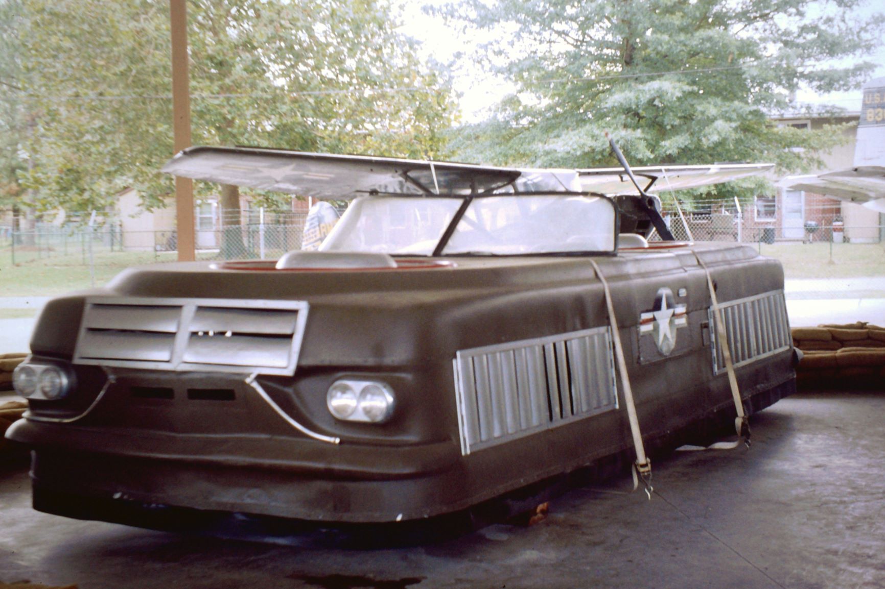

p51 wrote:
I can't recommend that museum enough to anyone in the area, it's near Norfolk. It doesn't have a massive train collection, but it does have a barn of RR equipment.
Personally, I thought the Hovercar took some beating !!
I assume it is still on display...
Certainly a Museum I'd like to visit again at some stage, though the USMC one at Quantico rates as the #1 museum of any type I have visited in the World for presentation and "experience".
