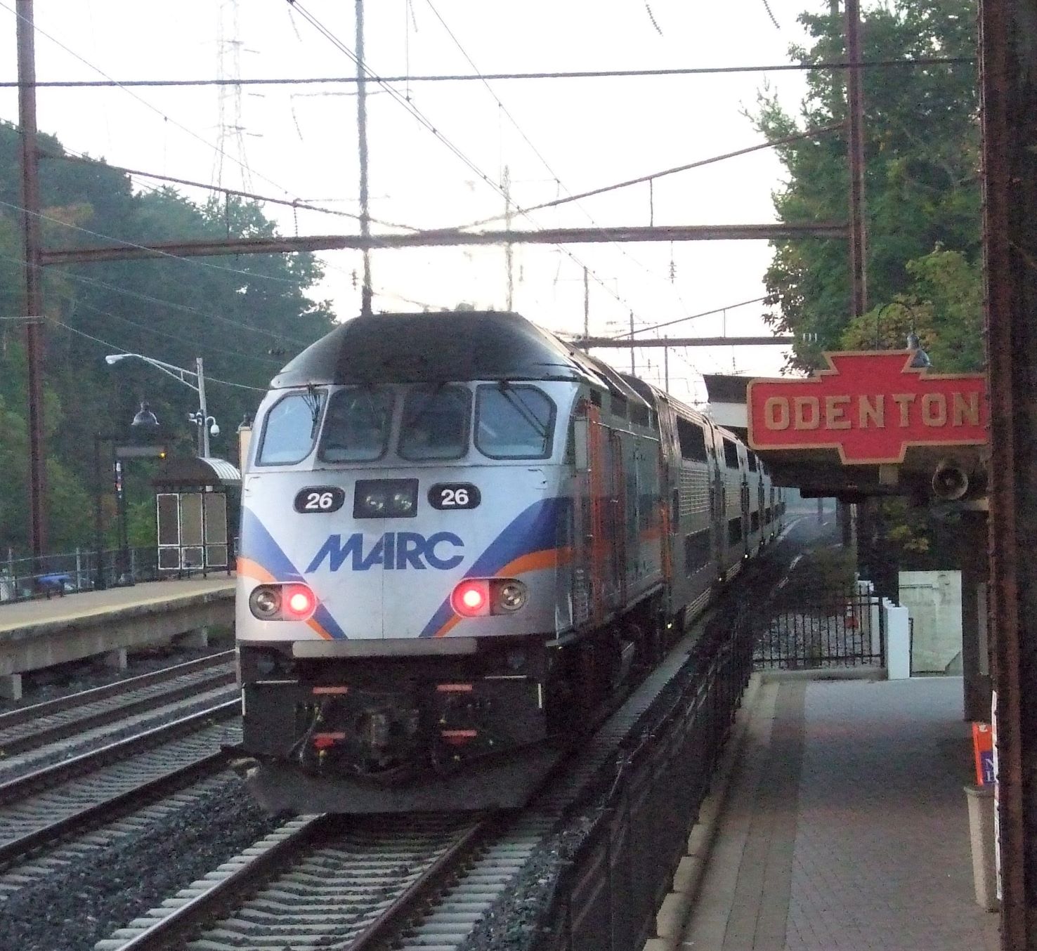

Some years ago, when I was still working for MARC, I was able to obtain a pair of reproduction PRR station signs for our Odenton station from a hobby/souvenir outfit. I don't believe I have seen them advertising for some time, though. Last time I was by Odenton, they were still there.
George F.Payne
Baltimore, MD
I did wonder if they were originals or not.....
As photographed in October 2016.

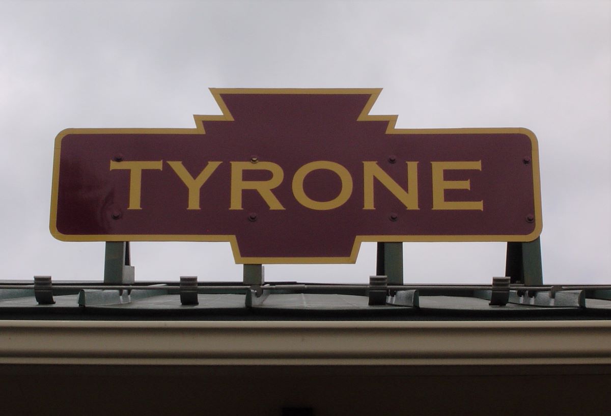

The one on the station in Tyrone, PA, in 2010, was just a suitably cut to shape piece of sheet metal that had been handpainted accordingly....
