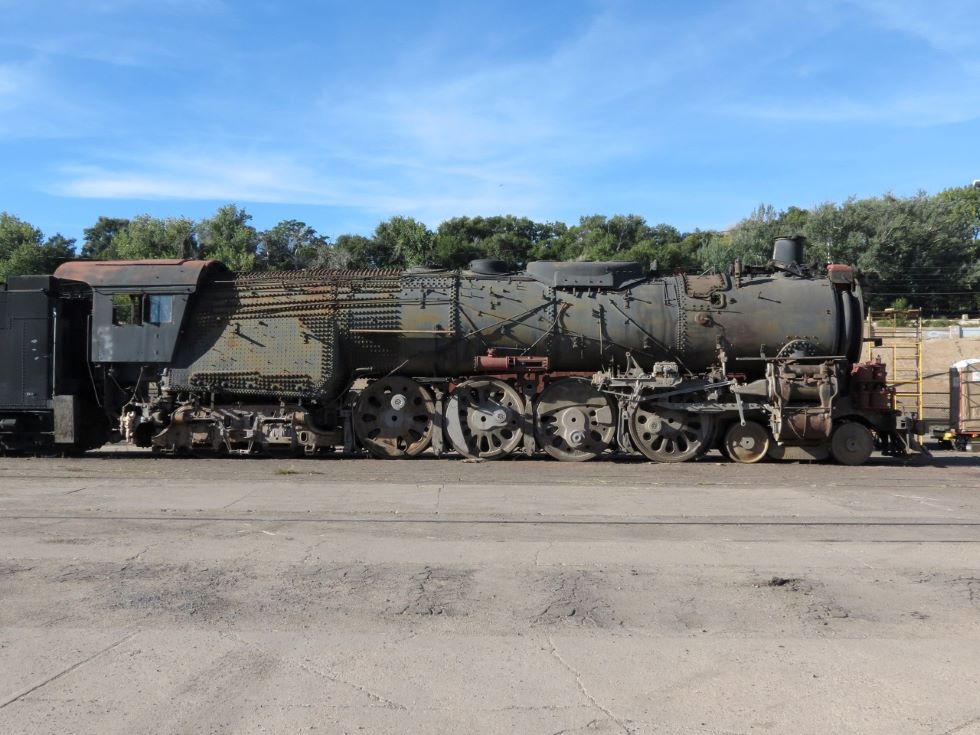

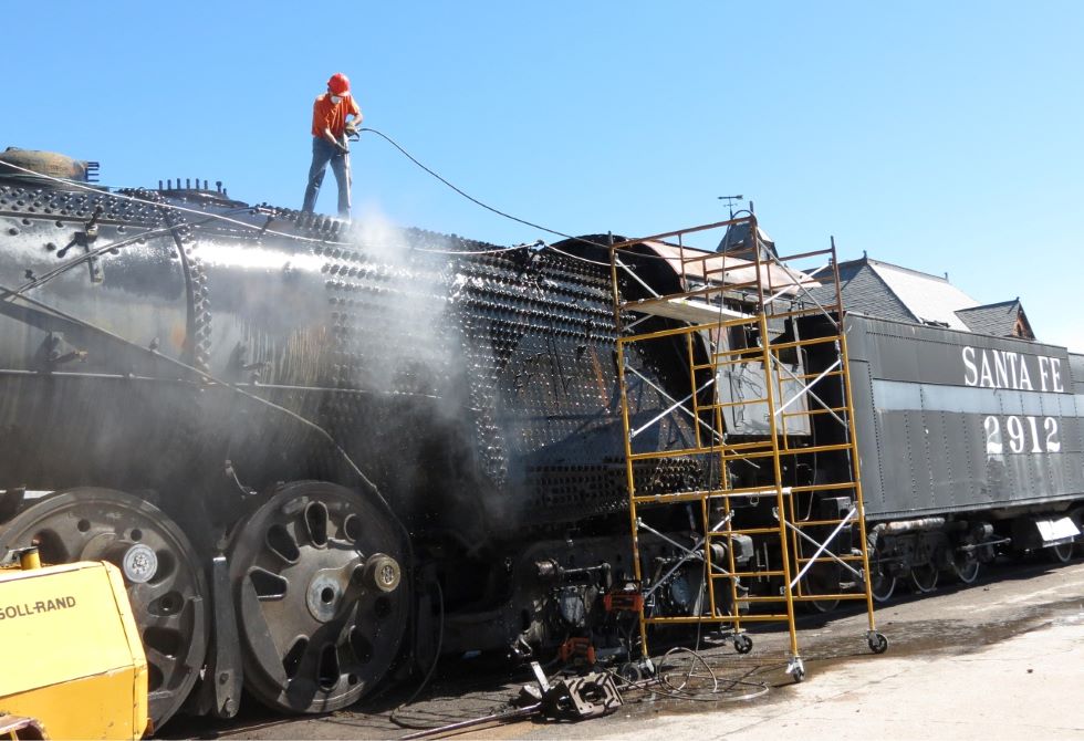

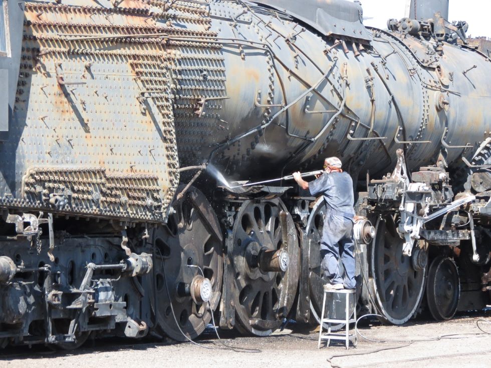

Pueblo Railroad Museum used water mixed what I believe was garnet to remove the paint from AT&SF #2912, I recall seeing an article about it in the Pueblo Chieftan around five years ago.
https://pueblorailway.org/roster/atsf-2912/
