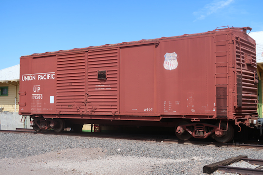

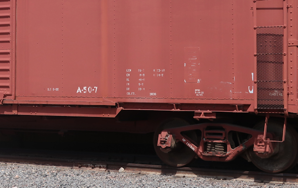

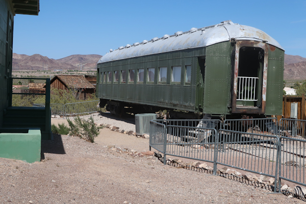

Here are some photos I took at the Clark County Museum back on April 29, 2018. I did not take a photo of the caboose on this trip. The coach has "SP" cast on the truck pedestals.
File comment: UP boxcar at Clark County Museum, Henderson, Nevada

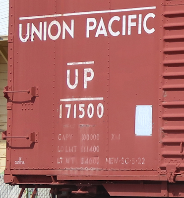

File comment: Box #171500 built 5-22
File comment: Harriman coach at Clark County Museum, Henderson, Nevada
Note the large single windows -- this is the early design

 Post subject: Re: Clark County Museum
PostPosted: Mon Mar 01, 2021 4:11 pm
Brian -
Thanks for the photos of the box car and Harriman coach. The lettering for the reporting marks of the box car look a "little off" to me. I would think that the third "line" should be under number 171500 rather than over it, but I'm not an expert on UP markings. Also, the car is described on one website as being a 40 footer but I wonder if it's actually a 50 foot long car.
PostPosted: Mon Mar 01, 2021 9:01 pm
Les,
I have to agree with you on all counts. The stenciling for the inside length says "40-6" seems wrong -- that might be where someone got the length. The class id of the car looks right A-50-7-- "A" for automobile. I think the "50" indicate the load capacity in tons -- not the length
File comment: detail of image, right side of the door
PostPosted: Mon Mar 01, 2021 10:31 pm
Brian -
Also in your earlier photo it says "NEW SC 5 -22". The car looks newer than 1922; maybe a rebuild?
PostPosted: Tue Mar 02, 2021 4:23 pm
Brian -
Your referenced photo for UP #161174 shows that the car had 7 "panels" to the right of the double doors whereas UP #171500 only has 5 panels. So, 171500 is apparently a 40' car. Whether the car number is correct or not is another matter. From the lettering on 161174, it does appears that the lettering on 171500 is not exactly correct. I agree that it would be nice if someone knowledgeable from the U.P. Historical Society could chime in.
PostPosted: Tue Mar 02, 2021 7:12 pm
Les Beckman wrote:
Brian -
Thanks for your comments and the additional photo.
Definitely a rebuild of an older car, the little gussets that hold the new sides out from the narrower frame are a dead give-away. You will also notice the height has been increased with an extra panel in the ends. There was a lot of rebuilding of older, lower, narrower wood bodied boxcars during the thirties; Youngstown Steel Door Co. even made "kits" for the sides to rebuild USRA cars. This isn't a USRA underframe, but the sides were adaptable to similar cars. Apparently changes to the tax laws on the eve of WWII brought this rebuilding activity to an end.
